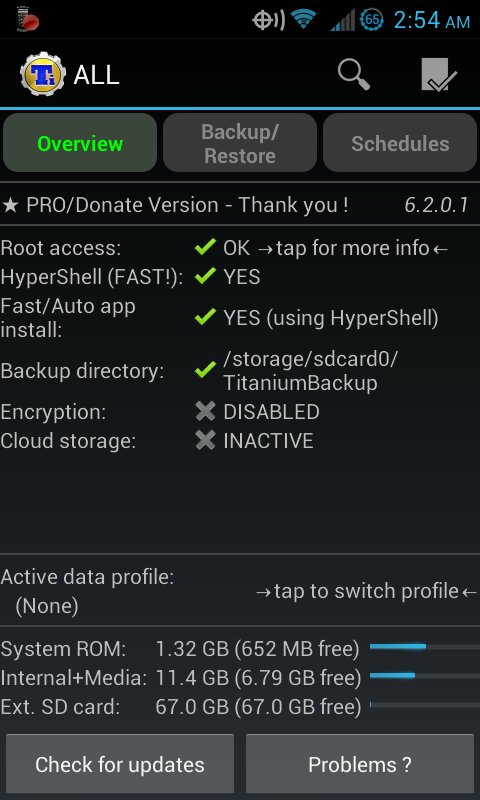

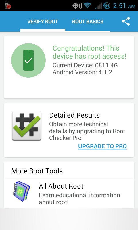

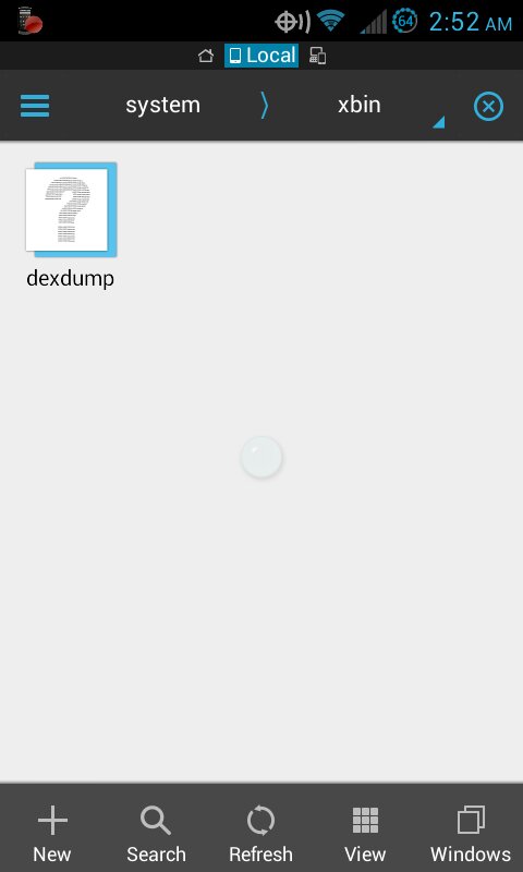

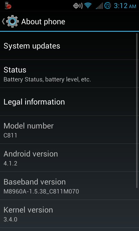

Ok, so tinkering around with a few things, I've discovered something.
I believe the problem lies in bin vs. xbin.
I decided to try copying the su binary into the system\bin folder. Upon a soft reboot, I discovered that SuperSU was no longer going into survival mode to force root permissions. I checked both bin and xbin folders, and the su binary remained. I made sure to turn off survival mode and did a hard reboot.
First, I opened SuperSU. No notification about binary needing updated.. OK! Second, opened titanium backup, granted permissions immediately.. OK! Finally, opened es and navigated to system\xbin.. No trace of su.bin... navigated to system\bin... Su.bin remains, and superuser permissions function flawlessly, with no surprise tweaks or supersu survival mode in use.
Theory: phone removes su binary from xbin at boot. However, it leaves it in the bin folder, and supersu reads it from there when it finds it absent in xbin.
Can anyone try this method with another superuser apk to see how it works?
EDIT: Screenshots immediately upon boot after battery pull.
Tried that. Removed SuperSU, su and surprise.
Installed fresh SuperSU and moved it to /system/bin/ within recovery.
After the boot, /system/bin/su persisted and worked.
But the update of su binary installed it in /system/xbin/su removing it from /system/bin/su.
So after every update the user needs to move the su binary to /system/bin/su.
The surprise method is more safe since if user forgets to copy /system/xbin/su to /system/bin/su after the upgrade he will loose root.
Did you try copying an old su binary to see if superSU would or wouldn't update it to system/bin?
Trying now...
Edit... Just tried it, you're right
