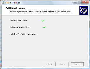

I was plugging along, the driver in place, now I'm stuck on the actual set up.
This is what's in the Additional Setups pop-up window...
Installing USB Driver (green checkmark)
Setting up Modem Driver (green checkmark)
Installing PdaNet to your phone... (now stuck)
Attached is a screen shot.
Any help would be appreciated!
if nothing happens start over
