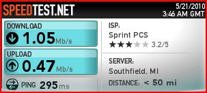

After reading from the first post to end post, I finally decided to give it a try and got it working using cheesemoo's method on my netbook running win 7 utimate 32 bits (Thank you cheesemoo). Since this was my first time doing tethering, and the readme file was not too detail enough, I had a hard time at first but finally got it to work. Here are some more installation steps for someone new like me to follow (Win 7 32 bit):
For step #3: my Win 7 did not ask for the drivers, and it would say cannot install device or unable to install hardware or something like that. I went to the drivers folder and manually install the drivers by running the setup application to install the samsung modem drivers. Then plug the phone in and win 7 will install the phone and will say device is ready.
For step #6, after installing the openvpn, you need to double click the openvpn icon on your desktop to activate it in order for step #8 to work. I was not able to get step #8 working until I activated openvpn.
Before you do step #7, I think you also need to make sure your usb connection/folder on your phone is mounted.
And last, if you are already on your home or office wireless/Lan network, you need to turn off your existing wireless or lan connection before you open your browser to go to the internet to test it out.
At my home, cell phone signal strength was very week (0 to 1 bar and no 3G) but it still worked, just very slow. My download/upload from speakeasy was 0.2-0.5/0.08-0.09 mbps/s (new york/los angeles). I will be trying it in an area with better cell signal tomorrow to see if upload/download get faster.
Thanks, it worked flawlessly using Vista Ultimate.
