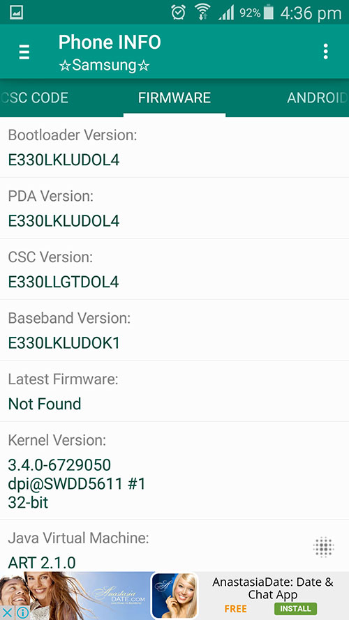

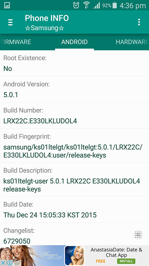

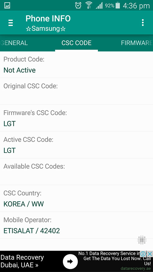

I'm curious as to what firmware is currently installed, can you check in Settings - About Phone, and check the build and baseband version? They should match and start with the model number. Can you post what it is?

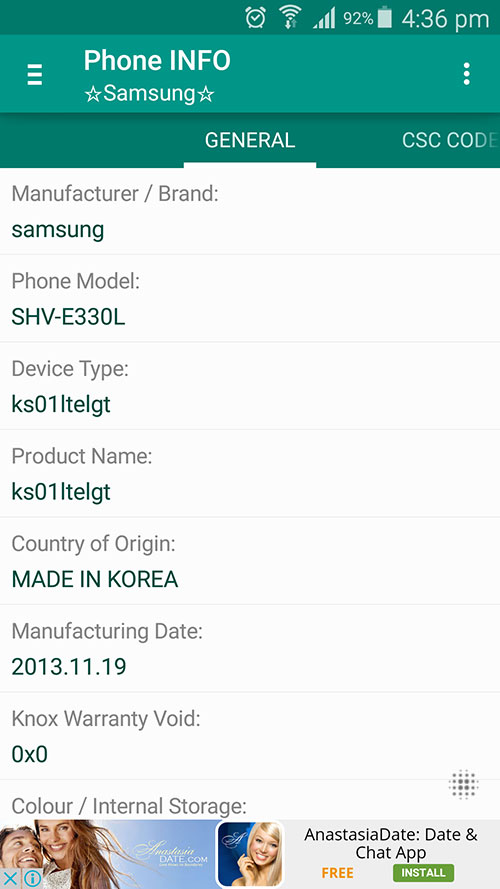

Model number is: SHV-E330L
Here is the screenshot:
I've been looking into a few things and usually the build number matches the baseband.
Your build is OL4 but baseband is OK1.
I haven't been able to find anything on OK1.
Not knowing the history of the phone, I'm not sure if this is normal or a different baseband has been flashed.
The baseband contains radio and modem data.
Still digging into it.
In a previous post,you mentioned that you had ask if the system could be reinstalled. The link to Sammobile is for the stock firmware that you could install with Odin. Might be what the repair man said may cause problems because baseband is different.
If you were to install it, I'm pretty sure the baseband would change to OL4 and I'm not sure how that would affect connection to your network . Firmware flash would put it back to bone stock Korean out of the box condition.

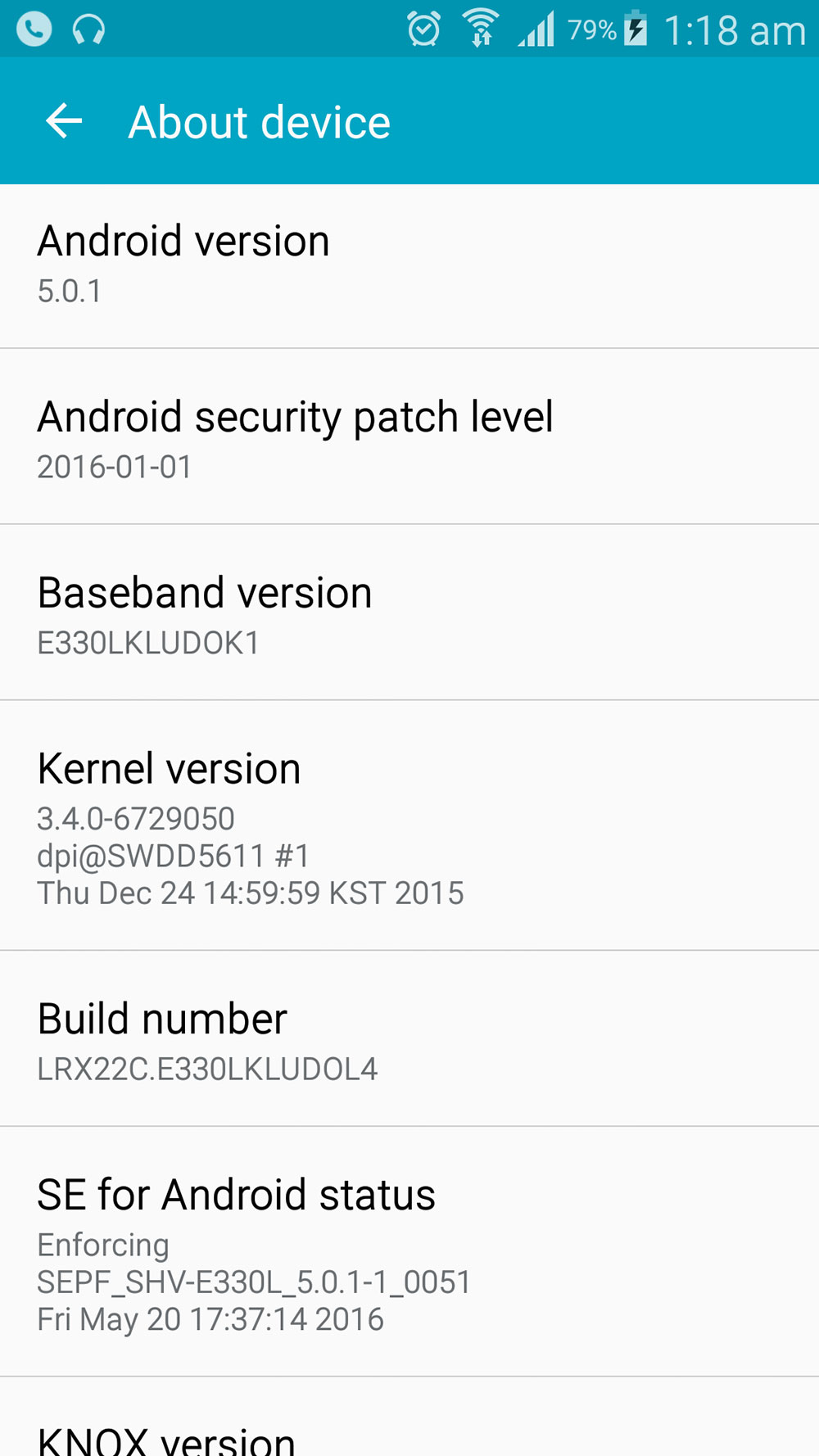

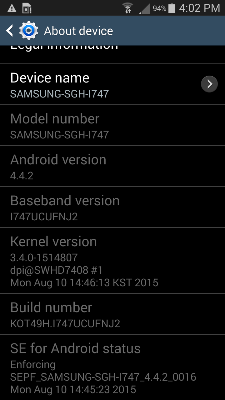

Here are three different Samsung devices. All are AT&T. A S3, S4, and S5.
Build and baseband match. All are Rooted but basically stock.
