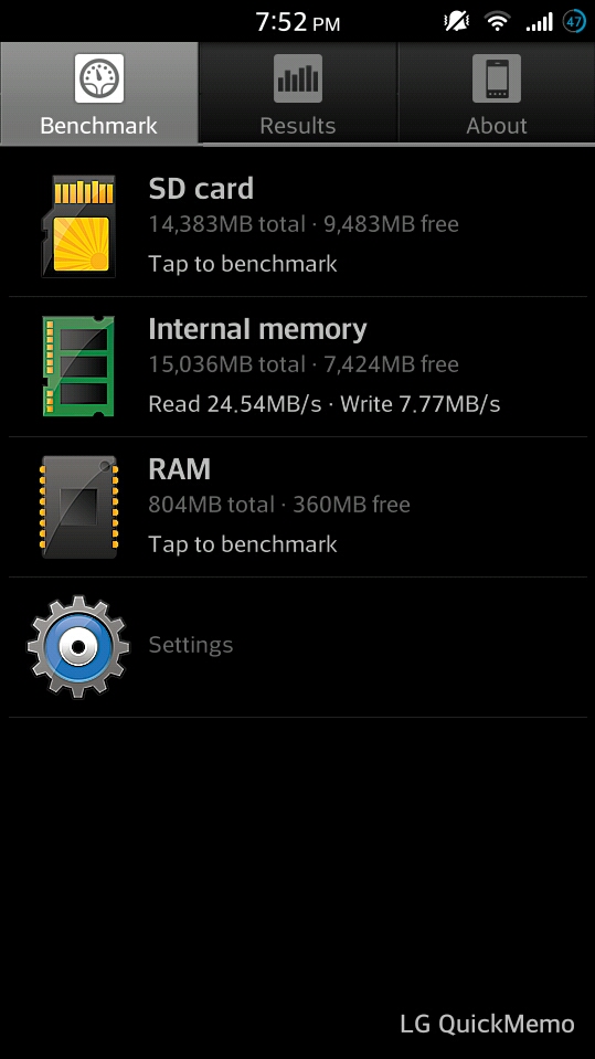

I'M SUFFERING lag and I don't know why. In the beginning it was ok with sometimes a little lag but now it's most frequently. I have a 32 gb SanDisk MicroSD ultra plus and the last update of xperion Rom running in my device. Anyone could help me?
@aangbell
Can you do a speed test on the card? If you have a Windows PC and a decent card reader, run CrystalDiskMark and let me know the read/write speed for the 4k test. Alternatively, install A1 SD Bench from the Play Store and do a Random I/O test on "Internal memory" with the hack active. Also, how did you partition the card and what did you use?
I did the test days ago and the result it wasn't the same. In this test the results are low. I did the partition with partition wizard tools. First the fat32 partition then the Ext4 like you said in this guide.
I think that something it's wrong because the MicroSD it's no bad for this I suppose. :(

Do the Random I/O test like I said. Long-press on "Internal memory" and choose "Random I/O." The test requires a reboot to finish. To do the test on the actual internal memory for comparison, flash -uninstall.zip in recovery. Run the test on "Internal memory" as before. To reactivate the hack again, flash -install.zip in recovery (skipping -copy.zip).
Did you purchase the card from Best Buy like in your link previously? If the card is genuine and the card performs noticeably worse now than when it was new, then the only thing I can think of right now is possibly misaligned partition(s) causing extra write/erase cycles. But the effect shouldn't have manifested already on a relatively new card.
Yes it's the same card. Ok i'm gonna do it.
Here is the result of the test with the hack. Without the hack result less like 0.18 mb/s on write. Well the case is that without the hack result less speed on comparison with the hack applied. :/
