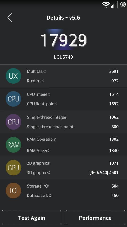

Just ran an Antutu benchmark with this installed. Got a pretty good score... Close to the cyanogen score. :)
