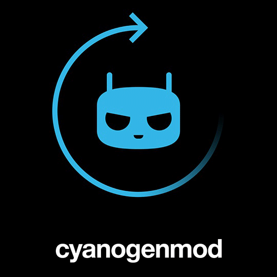

Here are a few boot animations that I have used on my Volt. The install location (for my phone atleast) is /carrier/cust/poweron/bootanimation.zip ENJOY! :D
The boot animations included are....
♦Android 6.0
♦Blisspop
♦Blue Plasma
♦Blue Plasma 4
♦Cyanogenmod 11
♦Cyanogenmod 12
♦Cyanogenmod 10
♦Cyan Nexus
♦Droid
♦Google Play (Nexus animation i think)
♦Modern Warfare 2
Download Here!-https://www.dropbox.com/s/jugpm5gfgwoc6kx/Boot Animation Pack.zip?dl=0
(A few are shown in the attachments)
