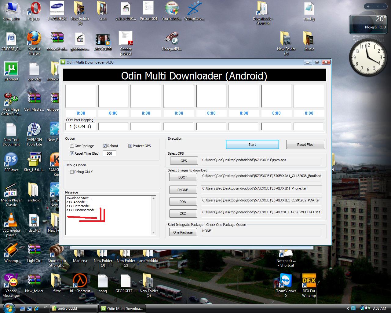

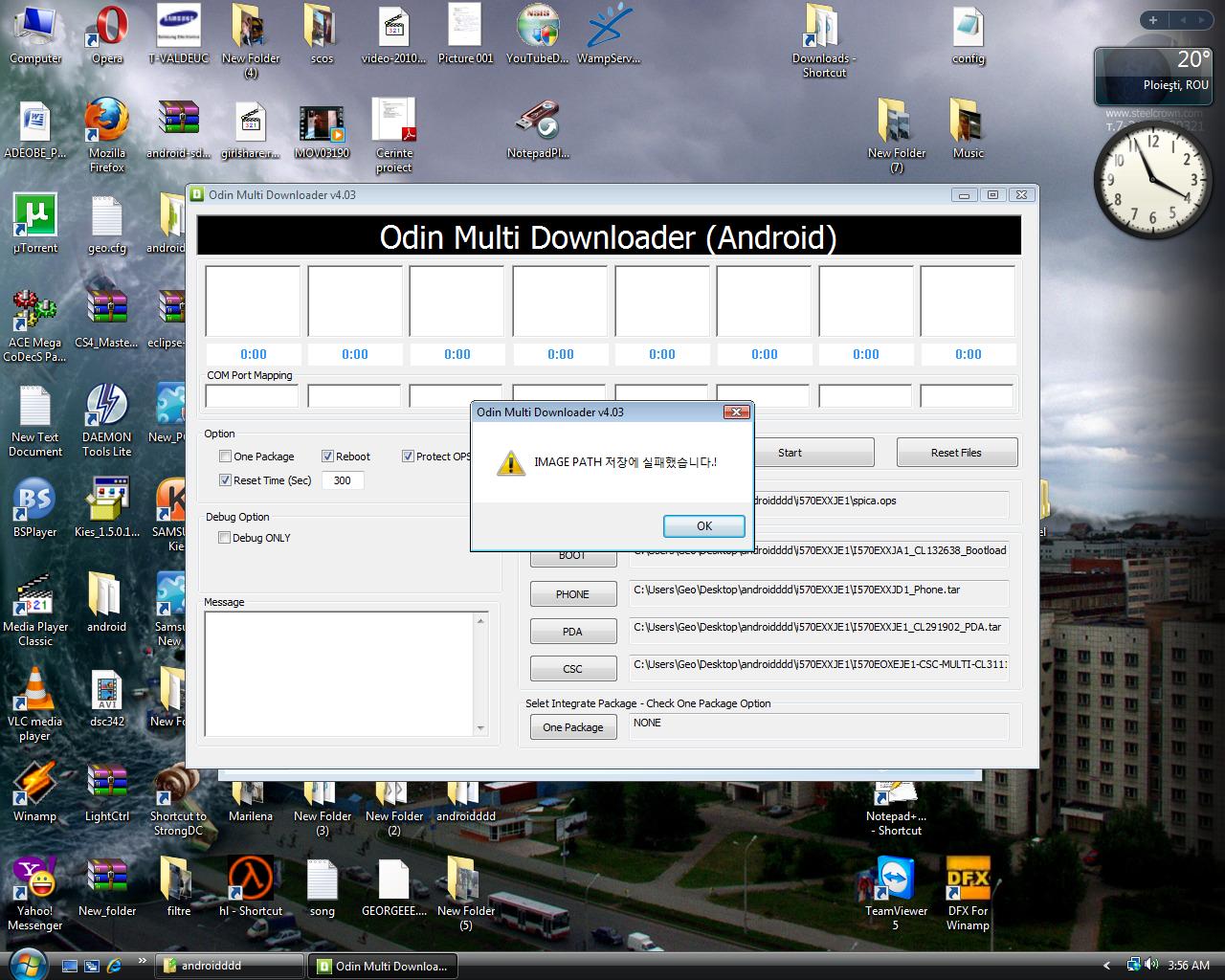

hi , tell me please how you put 2.1 on you;re spika . I tried and doesn;t work :(

You need the correct spica.ops file for the firmware you downloaded.
Save the following in a file called spica.ops and try it.
0,boot
1,Sbl
2,logo
3,zImage
4,datafs
5,factoryfs
6,cache
7,
8,modem
9,efs

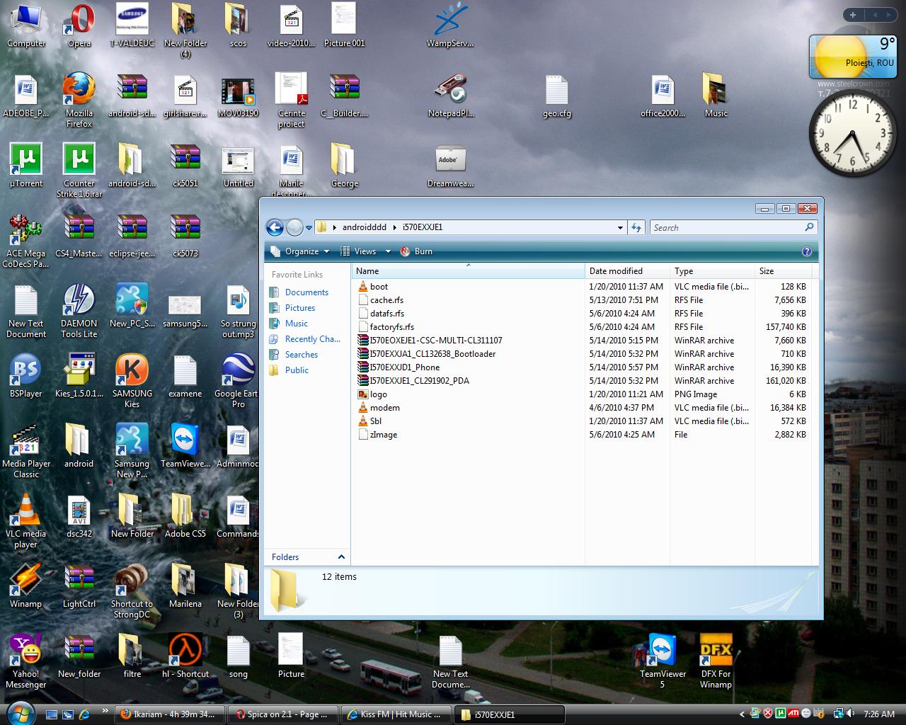

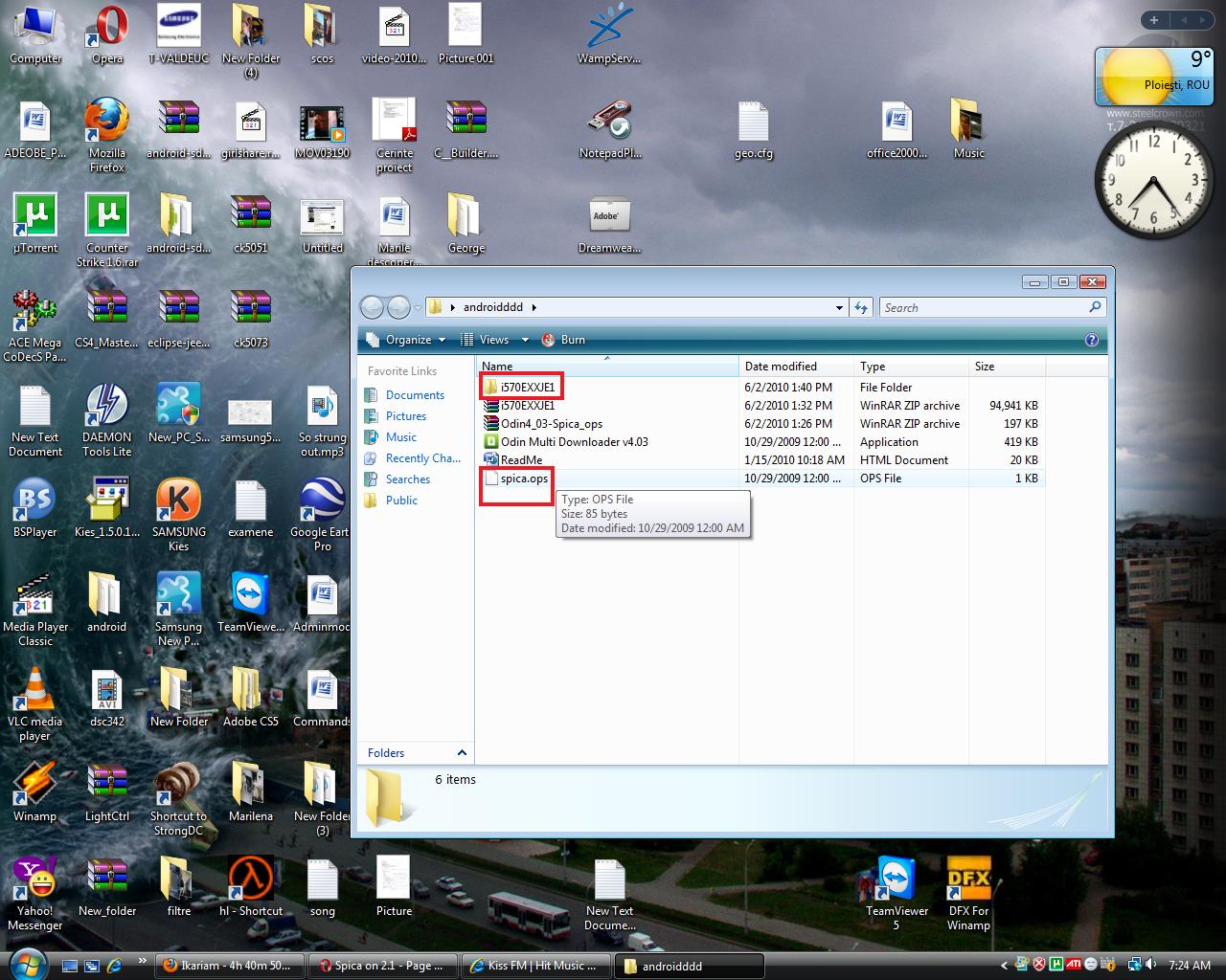

This problem could be because i don.t have the spica.ops file with the others file ?in the same folder?
No that's not a problem. It just makes it easier to run Odin if they are all in the same directory. try my solution above.

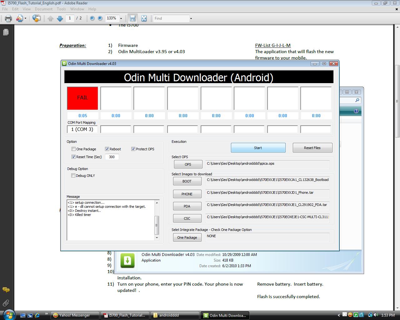

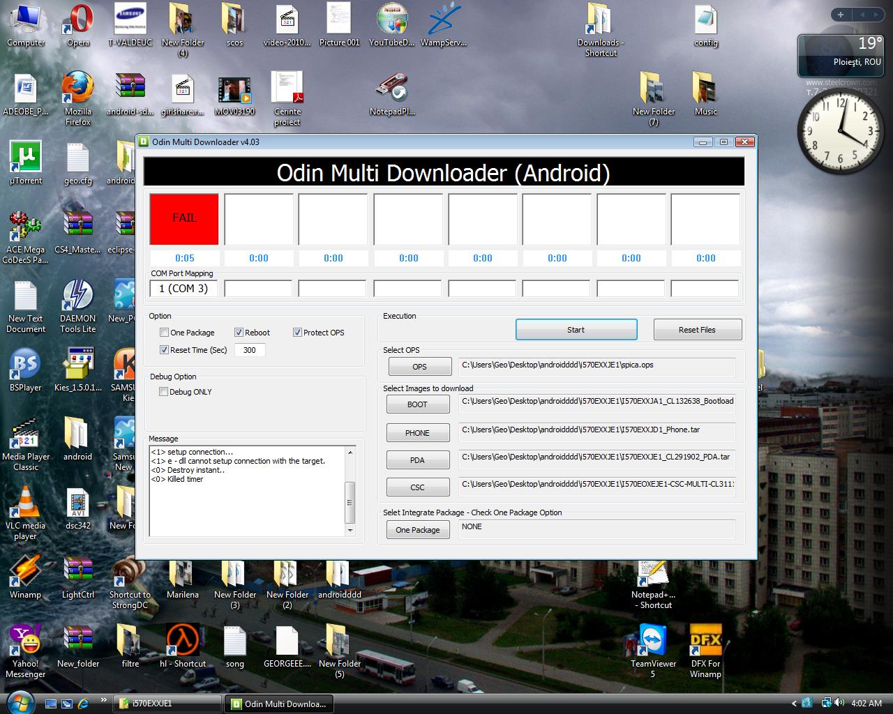

BEERKAN , give me some help : i don't understand what did you mean with put all that file into a spica.ops ( you refered at a folder named spica.ops? ) .The folders don't have extensions ..... Be more specifically !
I receve a message from program when i put the destination of spica.ops , etc : it is in chinese :D :)) ... . When i press that 3 buttons , the program conected my phone with pc but them it is disconected :( X(X(X(X(
Give me some help please !!! The actualy soft is so wrecked :((
