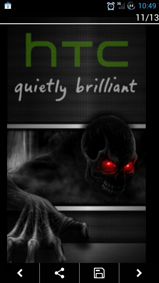

Not my favorite but this is what I'm using
I made this particular splash. I based it off a similar one that had a bit lower resolution so I just remade it to look more sharp. The other one was here Anthrax Development - Home of the first custom shooter ICS kernel
