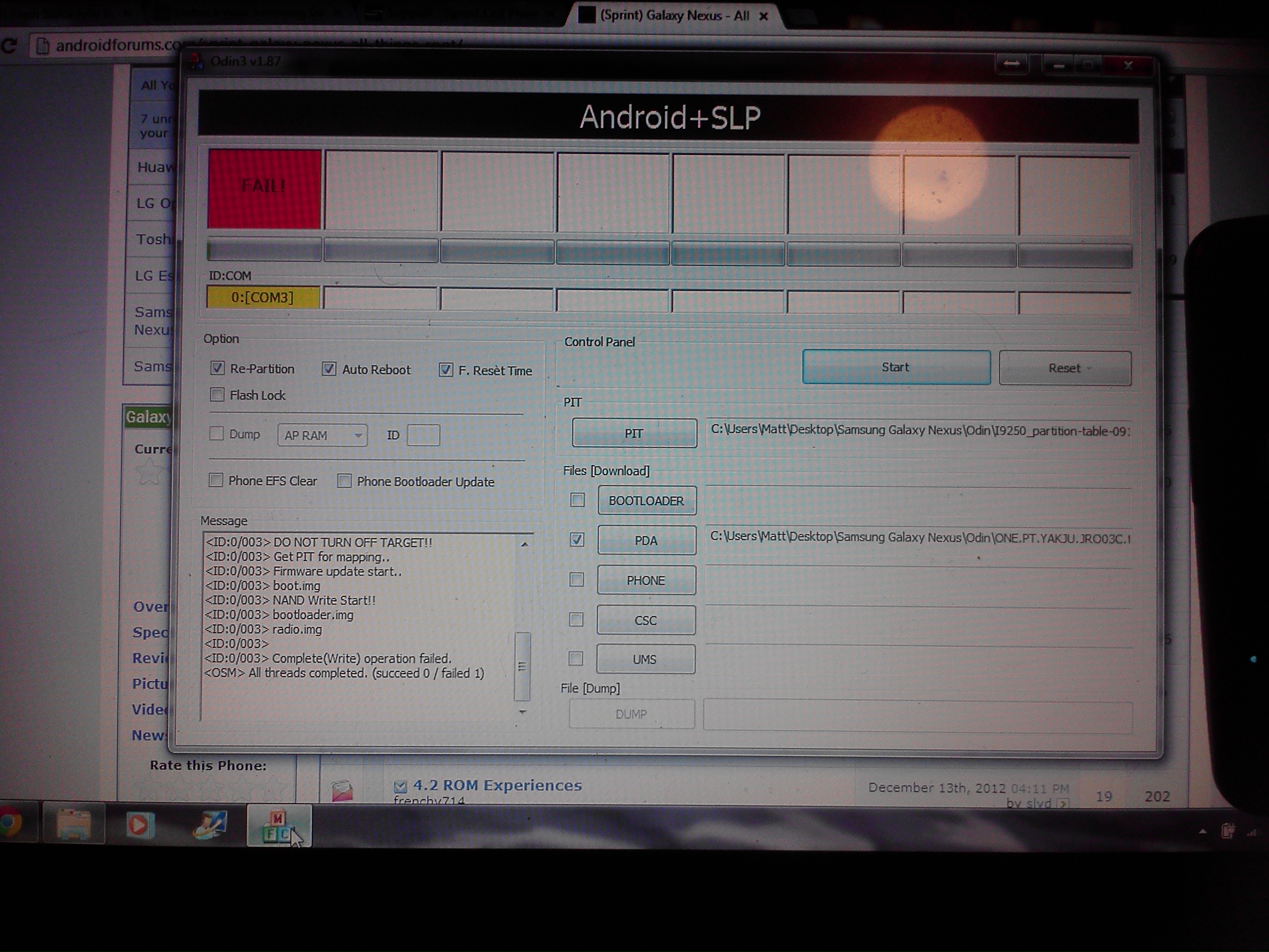

EDIT: I think I bricked my phone. Don't know if it's fixable. The Odin program failed while it was flashing, and now my phone only shows up with a picture, a phone, an explanation, and a computer. Pictures below. As if it wants me to connect it to my computer. I did, but nothing happens. It tried to install some drivers but they weren't found.
I tried booting into bootloader and Odin. Both of them resulted in the picture below.

I do hope the PIT file you used matches the model number of the phone you have. If not, you might have screwed up the partition mounts which in turn can seriously f*** up the phone and could result in a hard brick. At which point you would need a JTAG to fix or send the phone to a specialist to have it fixed.

Yep, you should not have used the PIT file.....You're probably screwed as I believe that PIT file you used is for a version of the phone that is a GSM version or the Verizon version and there's a good chance the mount points for that particular model that PIT file was made for are different then the Sprint phone.
From the info I've read, PIT files are generally not needed unless you're specifically trying to alter the partition table and mount points for them and such. Something which requires a PIT that matches the exact model phone you are using. Judging from the file name of the PIT file in your screenshot, you used the incorrect model. The Sprint phone is the SPHL700. What ever that PIT file is for is for a different version of the phone.
I don't think encrypting the phone would change the partition mount points and info in a way that would require having a PIT file when using Odin, so I don't know why you chose to use one....
EDIT:
It appears the PIT file you used is for the I9250 which is the unlocked version of this phone. The searches I brought up indicate that model phone has a 16GB internal SD storage. The Sprint phone has 32GB storage. Logically this means all the mount positions of the partitions will be different because of this. So definitely sure you hard-bricked it at this point. I think a J-tag device will work with this phone. But that's an additional piece of hardware you need to buy. I haven't read up on it and never used one, so I can't say for sure if it will work or not with this model phone.
EDIT:

And the reason I used that is I had used google and put in "galaxy nexus odin" and that was the first result, and as far as I can tell, it doesn't specify that it's for a specific version of the Nexus. I'm not really familiar with ODIN, it's files, or anything outside of MetroPCS's low-mid grade, easy to root phones. I was trying to be careful with this, since everything seems much more complicated and easier to mess up, but it looks like I lost this 1
