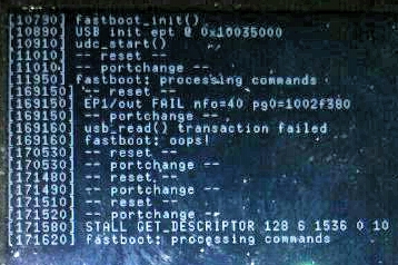

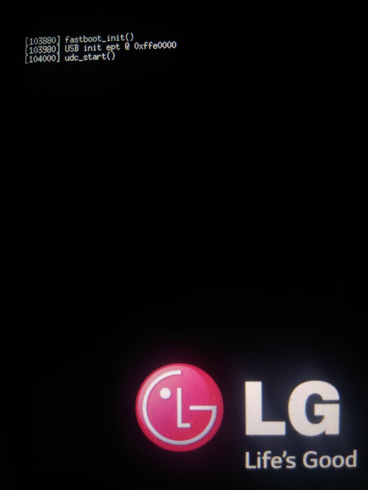

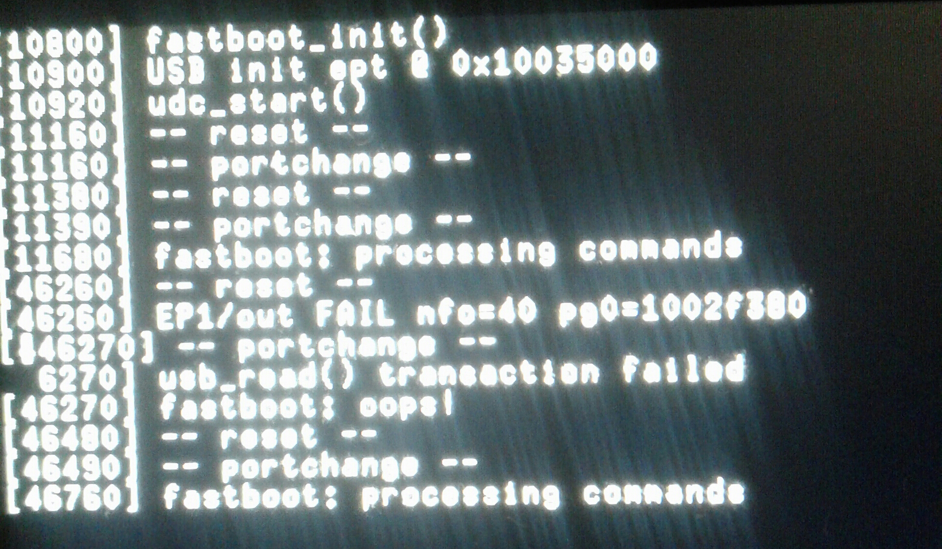

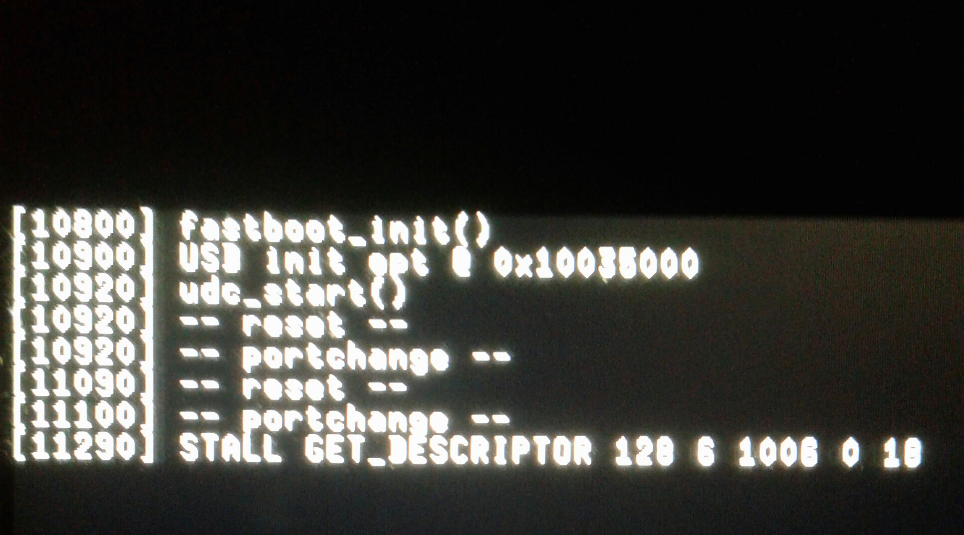

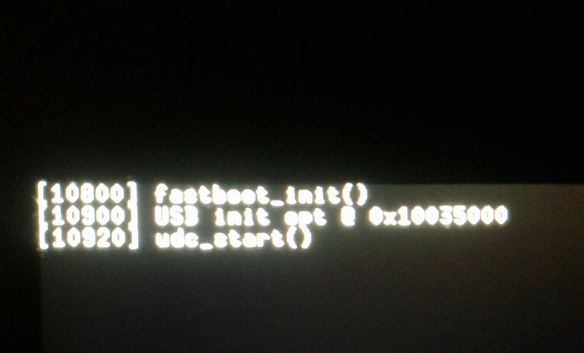

Hi. Could you please help me? I have old LG G Vista Verizon with stock android 5. I didn't do anything to it but it stuck on Fastboot mode.
It won't go to download mode (fastboot bulls**t appears at the same time).
It goes to recovery mode but it's useless (I tried hard reset, load into safe mode - fastboot appears).
I can't charge the battery because of it...
Fastboot sees the device, but any command doesn't work (FAILED: unknown command).
I downloaded kdz, extract laf.bin, renamed it to laf.img and try to flash it by command "fastboot flash laf laf.img" - same error (FAILED: unknown command).
It even doesn't respond to
"fastboot reboot".
Please help me...
yep 2014 is when this pre-paid phone came out. i would look to get a new phone.
if you really want to revive this ancient relic, then can you please post the output of your fastboot command? and you say that fastboot sees the phone, so just to be sure when you type "fasboot devices", you get a bunch of numbers, correct?
also post all of the outputs from the fastboot commands that you have tried.
