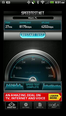

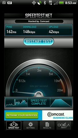

OK this is really bizarre. Right before I left my house I hit the 4G icon and was stunned to see that I had full bars. On occasion I get maybe one bar at home. Here is the screen shot of the speedtest. Oddly enough, I am now at work which is not in downtown Nashville but closer than my home is and I am back to the slow 3G, no 4G at all. Weird.
Well I going to post pictures, but I think it is Sprint having issues with there 3G service, I am still on PRL 21081 and did 3 test, one with WiFi on, one with 4G on and one with just 3G service, see below
Wifi On
attachment.php
4G on
attachment.php
3G only
attachment.php
