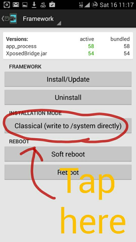

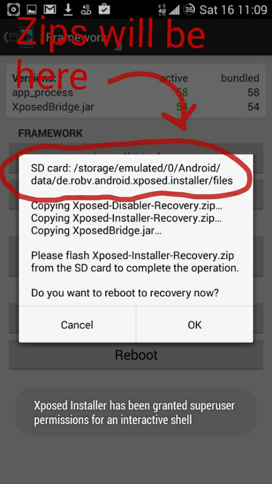

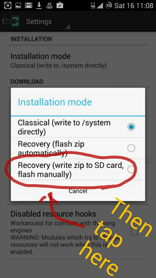

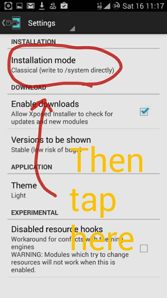

Yes you need to uninstall the xposed installer apk for lollipop and then install xposed 2.6.1. If you are not using a switcher for system rw you can install the framework via twrp by doing what I show in these screenshots. After doing what is shown in the screenshots just reboot to twrp, flash the installer zip, and reboot system.
