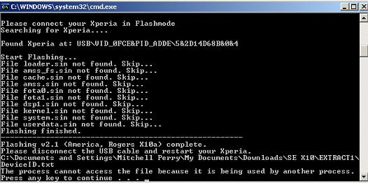

I thought I did, but then I realized the extract tool put the output both in the same folder. I extracted folder1 to extract1, folder2 to extract2 and tried again.
This time it went through the motions but still not flashed, device seems to be the same, still see the at&t logo on start-up, this is the errors I got during the flash.
It first complained about loader.sin not found and then paused for a minute and then gave a whole list of missing files.
Reflash when you choose firmware choose America generic (3.)
NOTE:As i said before it will still come out as a rogers branded phone.
Edit:If that doesn't work you may have to download the files again.But first try part 2 with the same steps it maybe that part1 messed up and something deleted the loader.sin file.

I got the same error, I will delete everything, download all the files, extract and start from the beginning.
i tried them all, the file corrupted i think.

dl that and put in ur FOLDER 1 where missing files. i got it Hellsrage, thanks alot from your help bro.
Part 2 , i have to extract to Part 1 to be able to re-flash for LOGO ROGER disappear.
OK, i am done. thanks much hellsrager619...also my phone showed network H, do i have to setup 3G or 2G? i dial the # you gave me but it doesnt do anything.

I've been directed to this thread to try and roll back my version from 2.1 to 1.6, in an attempt to recover my 300+ contacts that were backed up on 1.6 but now won't restore on 2.1
I've been through the procedure but run into problems when I run the "X10flash.bat" file. I answer all the question then when I get to "Select your computer's operating system" and press Enter, the file closes.
Not sure if I'm connecting the phone correctly in Flash mode - is there a knack to doing it when I'm already on 2.1 ?????
