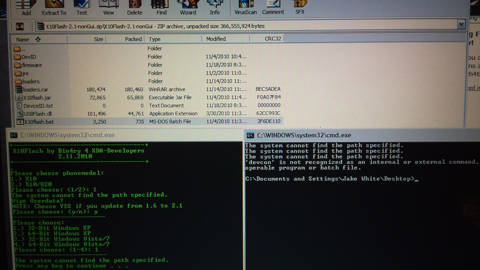

ok, i'm at a loss. i have a x10a that's locked to at&t and for some reason i can not get a single guide to work in my case. i've tried about 6 different guides made up from different ppl and i can't get anywhere on any of them.
i was trying a guide from a xda thread and i followed hellsrage619 link to this guide hoping it made more sense and was easier to follow. (if hellsrage619 could tell me what that thread was again, would be appreciated) i tried this guide and one other that was linked off this thread, both made the most sense while trying to go thru the steps.
on this guide and the other guide, i get to the same spot where it keeps telling me that "the system can't find the path specified." i'll try to attach a photo to show u what it says exactly. i have no idea what path it's looking for.
i was working out of organized folders under program files to try and do all of these flashes, but now i've just moved everything to my desktop. i'm tired of clicking on folders going back and forth. any help on this would be greatly appreciated. so far everyone i've tried to get help from don't make any sense. thanks in advance.
oh, i almost forgot to say that i'm doing this all on my laptop which has windows xp. i have no idea if it's the 32bit or 64bit. i don't know how to look that part up. i tried flashing using both options and no luck either way. i have also downloaded seus and se pc companion and everything else the guide calls for. just so u all know i'm not like some 80 year old that forgot to push the power button and that's y some tech gets irritated. thanks
Start XP in Safe Mode, and run SEUS, connect your phone in flash mode when asked by SEUS and it will install the flash driver. Then close SEUS and try again.
well.... done did that now and still has the same problem. so i'm at a loss. i have no idea what this devcon file it's looking for is. any suggestions?
so never mind about my previous statement. i was forgetting to do something very trivial and i finally remembered to do it. that's what happens when u try to do this too many times, u start leaving out important steps, lol. anyways, my x10 is now free from at&t and upgraded to 2.1:D. thanks for the guides and help.
