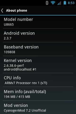

Has anyone tired to get cyanogen mod on their fusion 2 yet I've been waiting I really wish I could build it but I'm just a begginer hacker
UPDATE we have a beta of 7.2 running but we still have a lot of tweaks to perform
Only a few things ive had an issue with on cm7.2. Bluetooth crashes the phone. Cannot load cpu frequencies from cm performance settings. Tried huawei y201 oc kernel.. doesnt work. (No surprises there) Bluetooth was the only serious issue I could find after some tinkering, but likely more to come as it is beta.
