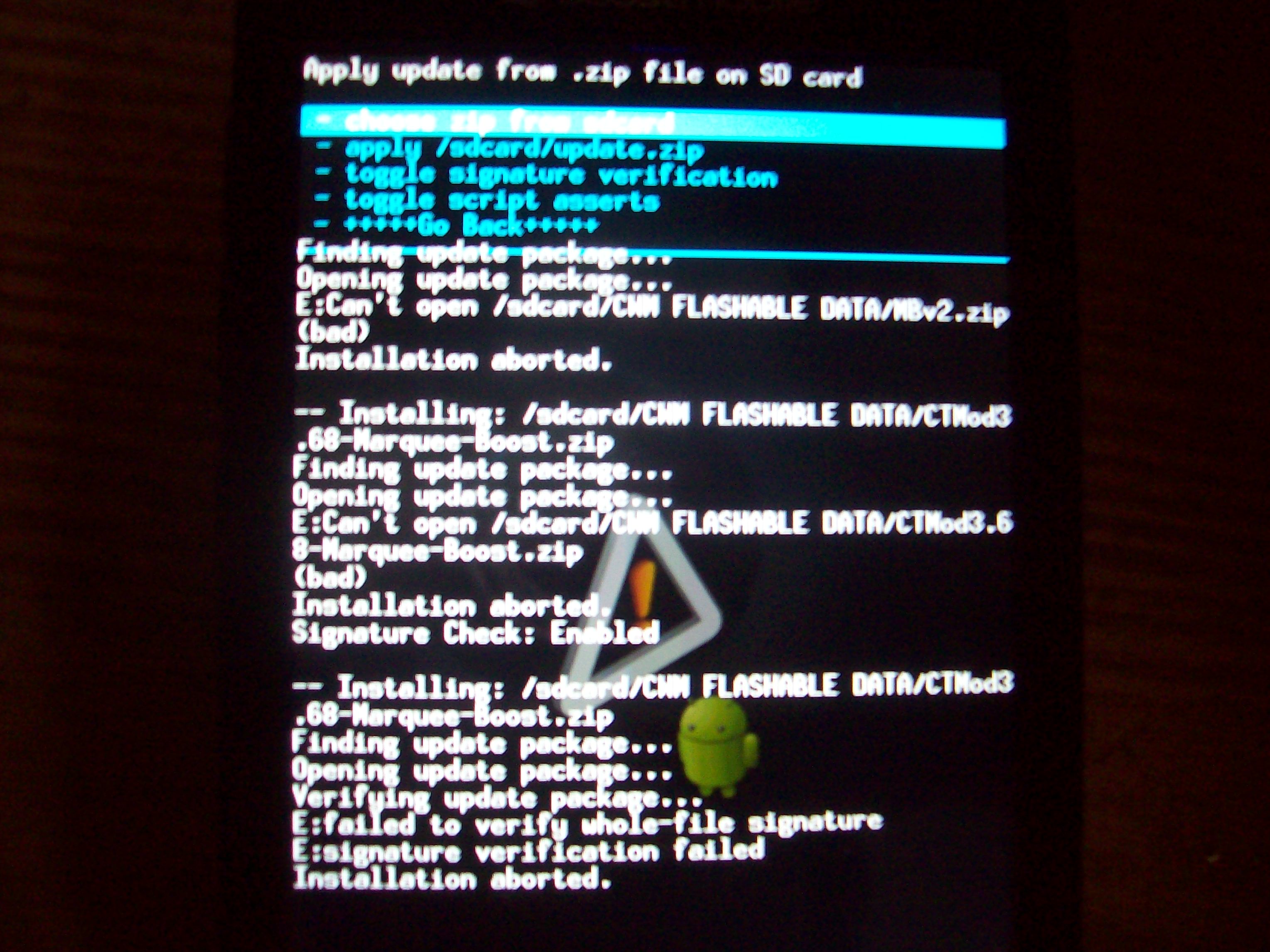

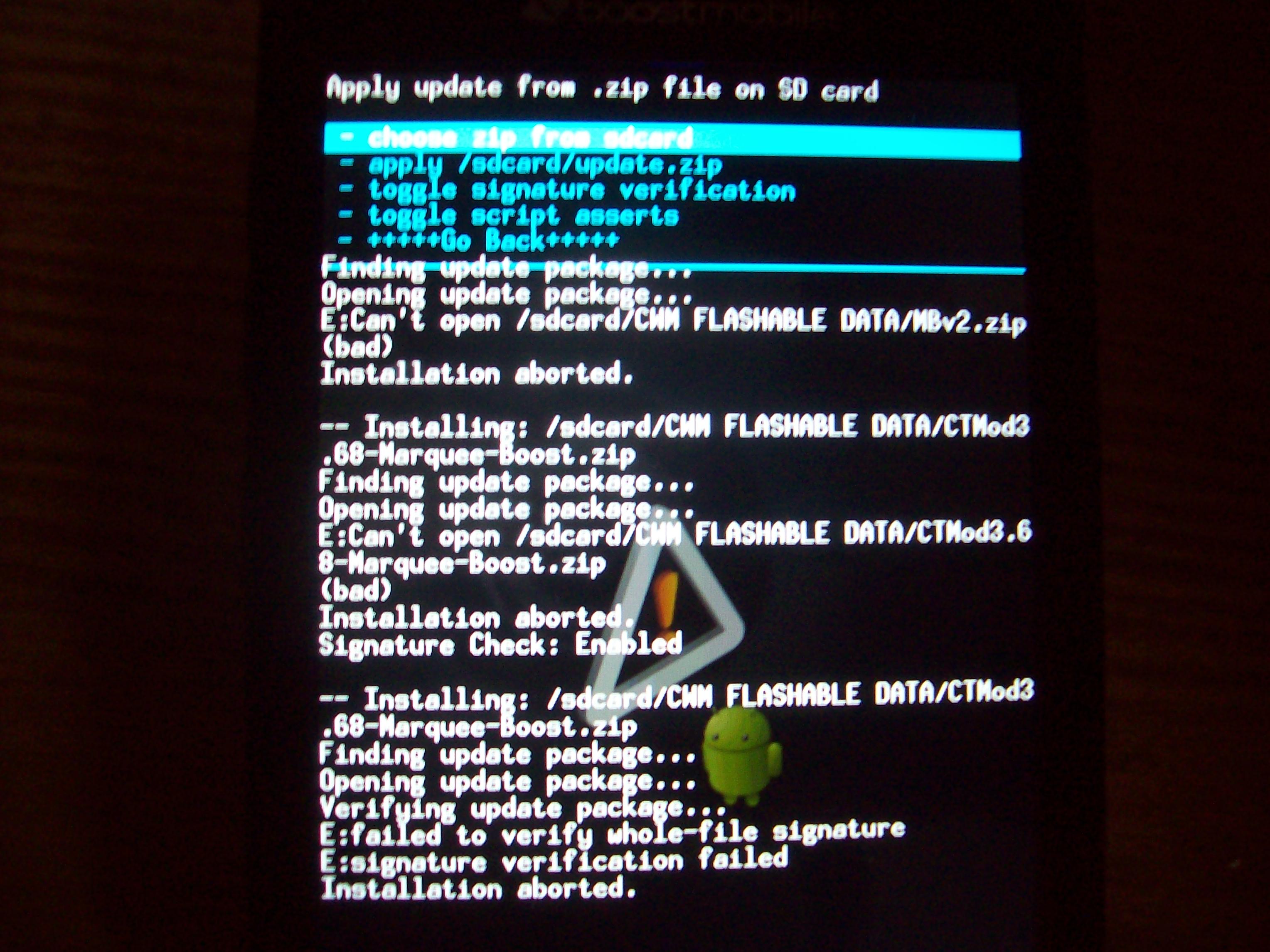

I can't flash any ROM at all for some reason. I've tried them all. I can't even flash CTmod 3.68 again. And I would like to do that because I would like my EQ back and now for some reason the stock music player says mp3's aren't supported by my phone. WTF?
I've attached a couple photos of what my CWM looks like with the ROM error.

I can't flash any ROM at all. I can only do a restore from my nandroid backup. I've tried them all. And my hotspot is the only way I can get online :( I have pictures of my CWM when the ROMS fail to install.
I've turned signature verification on and tried to install the ROM and i've also tried installing a ROM with signature verification turned off and still nothing will install. I'm downloading your nandroid backup right as we speak TryingToRoot. Thanks for your help guys.
hey bro, i noticed in your photos you're trying to install from sub-directories. my CWM does the same shit, i gotta copy ANY ROM to the root of my SD card. no problem with sound files (beats audio drivers) or themes...just ROMS. give that a shot.
No i'm not trying to install via update.zip. I've always been able to install from sub-directories, any advice helps so thank you. But I tried putting them on the root of the SD card. Still no go. But last night I put some ROMS on a different SD card. It let me flash MBv2 and I flashed a different PRL successfully which is what I wanted to do in the first place. Then it let me flash CTmod3.68. So I was happy, I booted into CTmod and it was being very buggy. So I tried re-flashing it and ran into the same problem. CWMR keeps doing the same thing AGAIN the pictures described above. I'm at a loss lol. I'm so damn frustrated right now. I don't know why it keeps telling me the ROMS are bad when I try to install them. So now i'm trying a 3rd SD card. And i'm at my parent's house because they live in town and have reliable high speed internet. All I have is my hotspot lol. So yeah, I don't know wtf is going on with my phone? You think maybe the memory in it (I don't know whether it's nand or what) may be bad? Or is my CWMR corrupted? I mean I'm no noob to Android devices. This is my 5th one I own, and I've installed recoveries and custom ROMS on my friend's and families devices. The Marquee just seems to hate me at the moment. It is a cool phone though.
