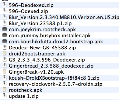

Got my replacment phone now i want to install GB
Before i start should i remove all the files from the sd card that have anything
with GB so i can start out fresh?
See attachment for list of files
And could you tell me or point me to a place with simple step by step that i can
follow. i don't feel i can do it becuse i get lost vert easly.
