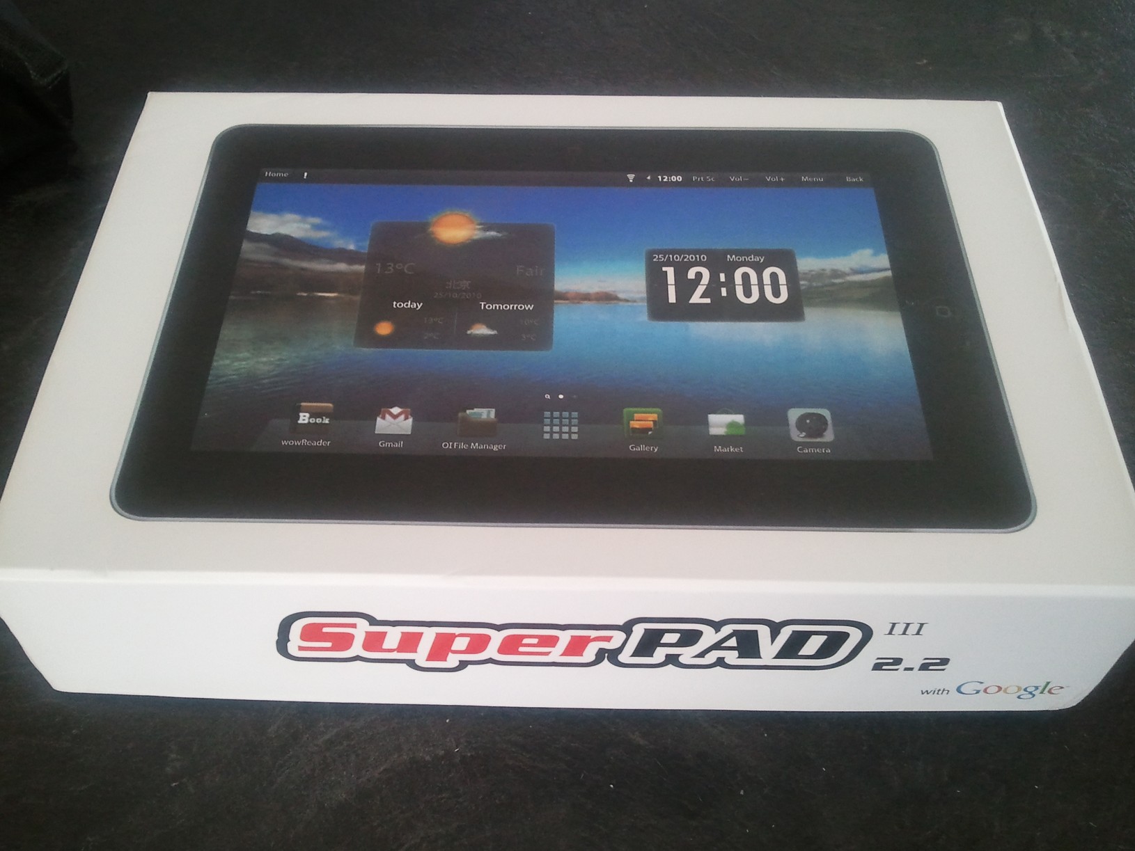

Hi Shane!
I've tested them all. for smaller screen size diffirence is visual but issue is picture quaqlity specially when you are using camera.
Do you have idea how to retrive os check bootloader from unit.
thanks Pedro
Shane,
Saw ur post at apad.tv and now i see you here...guess i've the same fate as you...no info/knowledge about which is real/clone superpads. Guess mine also a superpad3..being fooled by some local bastard...anyway, i'm not sure mine is using stock firmware or its been rooted. How can i check if its using tim firmware or other rom?
Sorry that i'm a noob and new user of Android. I hope we could help each other with so minority user of this SP3 and no manufacturer/forum/developer support.

Hi Rebooto,
Yeah had my account banned from Apad.tv for discussing these SuperPad 3's. They thought i was promoting the Fakes so here i am.
If you haven't done anything to it, then it would be using a stock non-rooted ROM. Tim's ROMs come pre-rooted so you don't need to root it after installing one of his ROMs. I can recommend Tim3a is a good ROM to load. Fixes a lot of issues. See the post above this one for a link and instructions on how to update.
