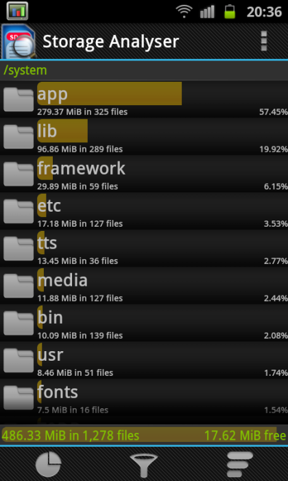

Does DiskUsage go to file level? If not, this app looks like it does:
https://play.google.com/store/apps/details?id=com.levelokment.storageanalyser
If you can figure out what file(s) are growing at that rate we might be able to figure out what's causing it.
ETA: here's my /system from the StorageAnalyser app. It's a sim free phone running GB.

I uninstalled and factory reset my phone in the past couple of hours but the problem still persists. Looks like everytime I switch OFF WiFi, my internal memory increases by 3-4 MB. That eventually grew to 1.4 GB and caused huge memory problems. Will try your softwares now. Thanks for the replies!
Quick Update - Tried the Storage Analyser but turns out that the /system folder is not what is causing the change in system data. I would think it is one of the folders amongst /sys and /proc. Read in one of the forums that this might be because of wifi error logs being generated but unable to act on the suggestions there because I don't have super user rights.
