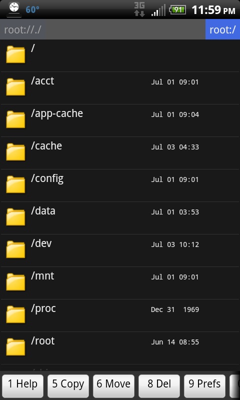

Ok took me a bit, but this is how I came across those strange files. Bear with me, these files are waaay down in there ( at least for me lol..)
I used "Super Manager" to get to them, I came across them while changing my boot animation.
Super manager> file explorer> secure> then I have to go back up a level to see these files: acct, app cache, cache, config etc... Go down far enough and you"ll see a file titled "Proc" in Super Manager I see what i guess are file creation dates? (yes/no?)
The proc file is dated Dec 31, 1969. Inside of it are a ton of files with numeric names like: 1, 1003, 1530, etc... if I keep scrolling I start seeing files like: Cgroups, cmdline, cpu info, exec domains, interrupts, last radio log, vmallocinfo, wakelocks, wifi data. I just saw these files while posting the file path here. All these files have the correct dates, or at least the date of Jul 2, 2011. Makes me wonder, would the dates on the folders being different between Proc and what's inside it cause there to be an issue with the machine "reading" said files? ( thinking out loud)

I have no suggestions, but I am using the Synergy ROM, and I looked and see a bunch of files listed with the 1969 date too. But also using a file manager with root access, I can see another 10+ files that also have the 1969 as a date, and they are not in the /proc folder, but they are on the same level. I am thinking your problem lies somewhere besides the date.
Here are the pictures of what I see:
Good to see it's not just me, with those odd dates. Didn't know if the dates were an indication of something else. Just seemed off to me. Since then i've seen files with other "strange", at least to me dates. Like 1970 etc...
