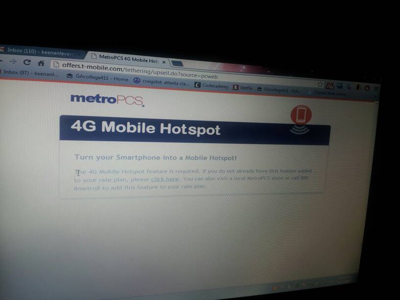

Same here i have been tethering on the BYOD and a message pops up on my laptop screen asking me to pay for the add-on,but i just bypass it. The message doesnt pop up when tethering to mobile devices though. And do i jave to have the tethering add-on if i have the $60 plan? I mean its UNLIMITED DATA

This is the message that pops up
