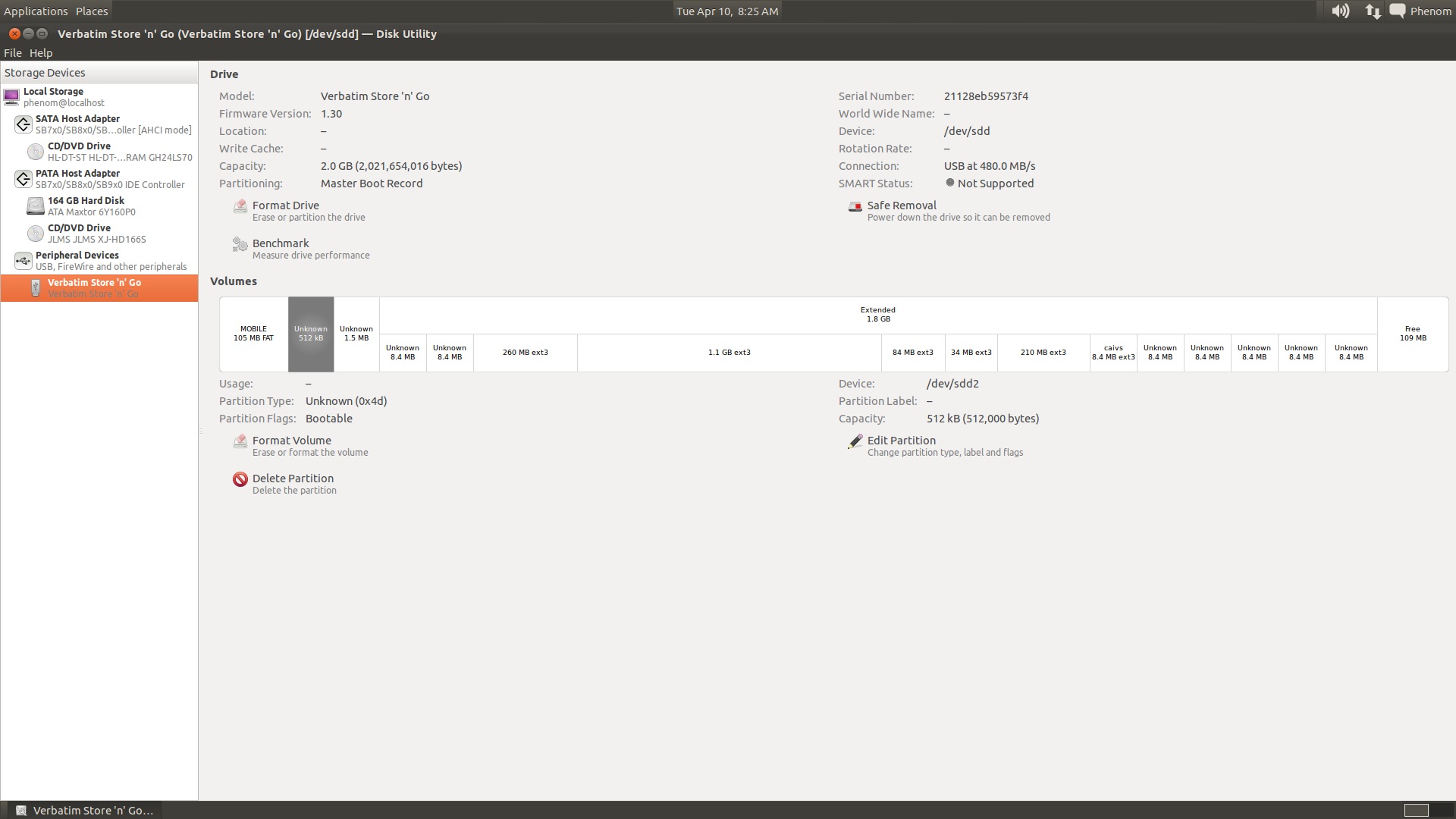

Well I read you could fix the partition table, I think I know two ways...
So, what kinda goodies you got for me? I think it did change the partitions, cause looking through the stock logs it says No such file or directory, Not granting permission, Error in initializing QCRIL CM, GW SIM(sec): Not ready --> Not ready, CDMA SIM(sec): Not ready --> Not ready, and a few others. Also, at the beginning of the radio log it says, RIL <--- CM_PH_EVENT_PRL_INIT(69670), but further in it says, RIL_REQUEST_CDMA_PRL_VERSION 8888.
Any ideas how to open the Unknown Partitions, File -sL says "DATA", so I'm thinking RAW maybe? Any suggestions on possible programs that might gain access? Check out the screenshot.

What is weird is:
1. Disk utilty sees all the partitions, but only reads 7 of the 16.
2. Gparted sees the usb as unallocated.
3. fdisk shows all of the partitions but the unknown results are different than disk utility.
Take a look at the attachment I posted above, and let me know what you think

I need somebody to hook their phone up in bootloader/download mode to a linux box and run the file manager as root to see the original partition names. Using Nautilus it says 34MB Filesystem but as root it says 3ce0a72a-54db-4aa6-995b-a414e87238af.
Just want to see what the regular partitions are named, other than mobile, cache, caivs, and userdata. Don't know if this changes with each device or not but, mine are :
16efd6ae-bd14-47a5-bdcf-0b67c9ed80e9
306b94c1-4e3a-43b4-a9a2-5457c99a933d
Most of the files on the partitions can be put in a .7z as root, but one I had to tar.7z. I would like to be able to get us a full partition backup without the meid changing, but I believe that data is stored in one of the "unknown" partitions.
ok, when ubuntu mounts partitions that it does not know the filesystems name it will mount them using the blkid, this is what you are seeing them mounted as. if you use the command line and run sudo blkid it will print out the blkid of all known block devices(drives, partitions) as well as list what device they goto. if you look at my thread you will see the 2 different layouts, CM7/CM9 remove the partition labels but the partitions still remain for the same uses.
