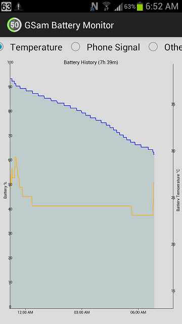

I am trying to post images of my battery readings to this forum for interpretation, can anyone advise as to how to do this?
I have uploaded pictures to Photobucket but cannot determine as to how to insert the image directly into my posting, can anyone advise?
I am making a pigs ear of inserting this image - bear with me. How do you change the size of the image?
Can anyone explain in laymans terms as to the information being displayed in respect of good/bad points?
