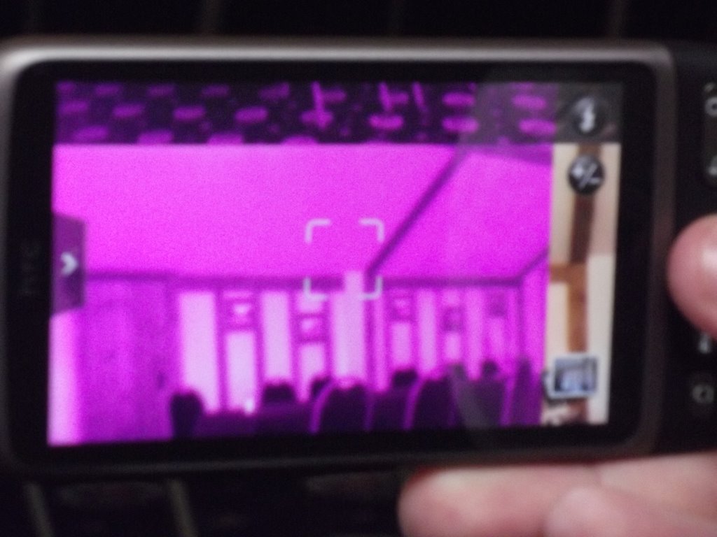

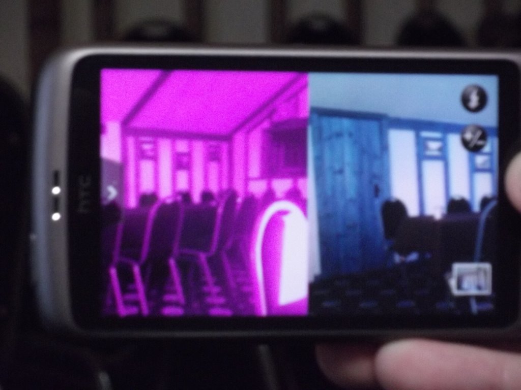

Easy way to test is to go to the phone settings - Wireless and Networks, and set it to "GSM Only". Wait until you get a G or E connection, then sync all. This will get the data working. Open up the camera, take a photo, go back to the camera, and wait. If your phone suffers this issue, you'll get this. (Actual photo f my phone). Or actually much worse if it's downloading anything major. I had some really bad issues in Camcorder mode, it was like it was loading a ZX Spectrum game.
