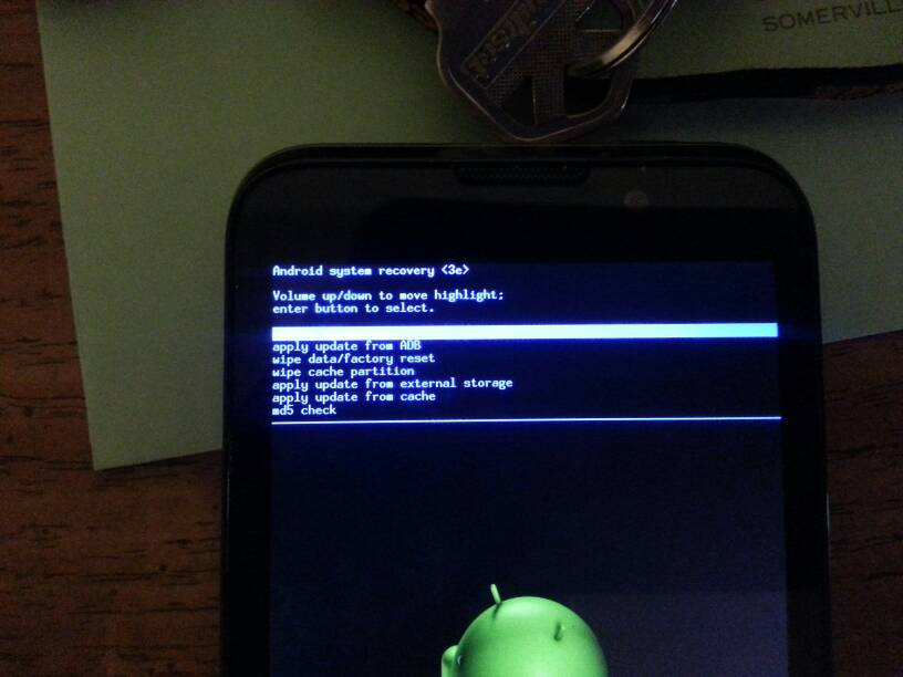

This how it looks medium brick

I hope this help check out the pics let me what u think soft brick or medium brick

its not 100% bricked, it can be recovered at least to a point, as i said before, the extent of the damage cant be told for sure but if you had a computer and manually hacked the hell out of it you could probably recover it. that requires a.computer, and manual hacking tho
no zips will flash in syock recovery they lock it, the only ways to recover it are the zte update tool, which requires an official update first, and going in over adb through a computer to either force a working cwm or manually force the system back.in there right
if you really wanna go that route and try to recover it that is up to you but without a pc its impossible
its probably just what they call soft bricked, no damage to.anything but system, but fixing it without a conouter in its current state cannot be done
im not here to try and trick you out of a phone, thats not me, but with no pc theres nothing you can do and i should be able to not only recover it with a little work but use it to make a working cwm and get cyanogenmod going

So how do I go about doing this? I get reboot system now, apply update from adb, wipe data/factory reset, wipe cache partition, apply update from external storage, apply update from cache, md5 check.
So far I have done the data/factory reset, and I have wiped the cache partion. As those are the only 2 options I have. I can't get into my phone when I plug it into my computer to see the files. Maybe I have to choose one of the options. I don't know about the money situation about why the guy didn't get the money. He should have. However I am not trying to start anything as I don't know the situation.
