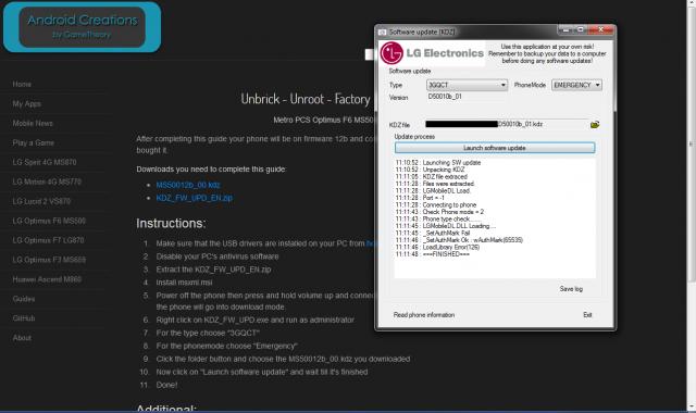

Hi, I have a MetroPCS Optimus F6 and I want to flash it to T-mobile ROM. I followed your instructions to a tee but it didn't work. My phone was in download mode and the screen never changed (I eventually had to pull the battery). When I chose the D50010b_01.kdz and clicked Launch software update, I noticed it said "fail" a lot in the log.
My current firmware is MS50010i. My phone is unlocked but not rooted.
Do I need enable usb debugging or something? Thanks in advance
If anybody could tell me what i'm doing wrong, I'd really appreciate it. I have attached a screenshot of the error it gives me
Did you root and have a custom ROM on the device or was you coming from a carrier ROM if not you need to root to perform this task
A lot of people have been having that error, but noone has a real solution to this. It has something to do with Windows. In the past when I had this error I updated the windows .net framework then rebooted my PC and reinstalled the LG tools/drivers and everything worked after that.
I finally got it to work on a Windows 8 computer. Windows xp and windows 7 gave me those errors but Windows 8 went smoothly. Thanks for the tip
