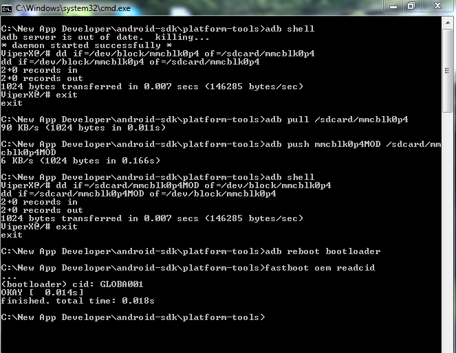

Here's what I've been doing!!!
C:\New App Developer\android-sdk\platform-tools>adb shell
~ # ←[6n dd if=/dev/block/mmcblk0p4 of=/sdcard/mmcblk0p4
2+0 records in
2+0 records out
1024 bytes (1.0KB) copied, 0.009430 seconds, 106.0KB/s
~ # ←[6nexit
exit
C:\New App Developer\android-sdk\platform-tools>adb pull /sdcard/mmcblk0p4
142 KB/s (1024 bytes in 0.007s)
C:\New App Developer\android-sdk\platform-tools>adb push mmcblk0p4MOD /sdcard/mmcblk0p4MOD
47 KB/s (1024 bytes in 0.021s)
~ # ←[6n dd if=/sdcard/mmcblk0p4MOD of=/dev/block/mmcblk0p4
2+0 records in
2+0 records out
1024 bytes (1.0KB) copied, 0.006165 seconds, 162.2KB/s
~ # ←[6nexit
exit
C:\New App Developer\android-sdk\platform-tools>adb reboot bootloader
C:\New App Developer\android-sdk\platform-tools>fastboot oem readcid
(bootloader) cid: GLOBA001
OKAY [ 0.014s]
finished. total time: 0.018s
I have attached 2 screenshots. One is the mmcblk0p4 file before the MOD and the other one is after the MOD. I have substituted my EMI number with asterisks (*). I hope this gives you more insight in whats going on!! Thanks!!

Here's a screenshot of the actual CMD window on my PC! I didnt think I had to do "su" since adb shell already has "su" privileges. If you see under the command line there is a "#" which I assumed meant I have "su"..

so if im understanding correctly,you dump mmcblk0p4,change it,flash it back,cid doesnt change. then you pull mmcblk0p4 again,and find it unchaged from original(11111111 is gone)
i hate to ask an obvious question,but are you sure your changes are being saved? you might open the image you pushed back(the one in your platform-tools folder) and make sure its actually superCID'ed. if its NOT,then maybe run HxD as administrator,if you havent been.
failing that,im afraid that if your phone has OTAed,youre now on a set of firmware where htc has wisened up and write protected 0p4 while s on. :(
there may not be a way to superCID JB OTA'ed devices yet... let me dig around and see if i can find anything out. :)
may be a grasp at straws,but you might also try the commands with the phone in recovery. it may have more access than system.
ive a feeling that folks that have succeded on 2.15 were either s off allready,or not running the full fimrware,possibly leaving 0p4 unprotcted like it was in older versions.
ive got to get to work,but ill search some more later this evening :)
Ok, what I do is, dump mmcblk0p4, then I right click on HxD editor and run as ADMIN, then I navigate from within HxD to the mmcblk0p4 file. I open the file and change GLOBA001 to 11111111. Then I save as mmcblk0p4MOD. I go to my (platform-tools folder) and I see the original mmcblk0p4 file and the mmcblk0p4MOD file. Then just to be sure, I right click on the mmcblk0p4MOD file, open with HxD editor and the file has the change (11111111), both files are the same size(1K). Then I follow the instructions as you can see in the screenshot in the above posts but nothing changes. Should I be saving it as mmcblk0p4 and NOT as mmcblk0p4MOD??? I have tried it in recovery aswell. I have tried it with USB storage mounted and without, but still no luck... I think you might be right about HTC having wised up,lol!!! Had I known I would have never OTA'ed!! Im gonna try changing ROM's ( Dark-Jelly-S-Edition-Build-12.1.zip CM10) and see if that does anything!! Hopefully if it does I will let you guys know here!! Thanks for your help!
Ok, I changed my ROM to (Dark-Jelly-S-Edition-Build-12.1.zip CM10).. Its running great, I enabled developer options, turned on usb debugging and gave it another try!! Check out the screenshot to see what happened and let me know if I messed anything up!! Thanks again!!

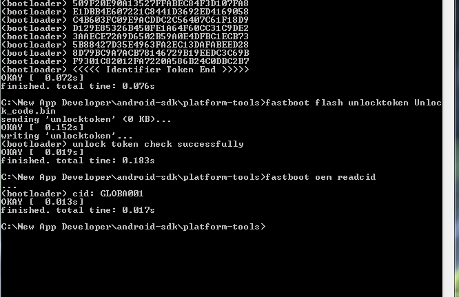

Dang write protection, lol!! I had a reply from an XDA member yesterday that said to try this,Quote: "After you flash the hex-edited file you need to re-lock and then get a new token and unlock again....after that you got supercid unlocked which you need for s-off "... In your opinion do you think this can work and by new token does he mean the HTC-Dev process to unlock the bootloader which will give me a new Unlock_code.bin file??
i saw that as well,and it dint make a whole lot of sense to me. when you flash your hex edited file,its not changing anything becasue of the write protection. it wont matter if you relock or not.
the gist of what he was trying to say,i believe,is that once you change your CID your original unlock_code no longer works,youll need to get a new token,and then a new unlock code. this part is true... however i dont know why youd need to relock and re unlock to s off,the second unlock is not any different than the lock you have after supercid.
you could try relocking,getting a new token and unlock_code,and re-unlocking and then try to superCID again if hopes of the new unlock on JB will release the WP on mmcblk0p4,but i doubt that provide any different results. :(
you might also try,sor S&Gs if it will let you change the CID to HTC__001. if so,maybe mmcblk0p4 is only blocking 11111111. if you can successfully change the cid to something other than 11111111 and have it stick,try changing it to 22222222 for the s off process :)
Thats a good idea, I have never tried to change the Cid to anything other than 11111111. So you're saying I should try to change it to HTC__001 and if that works change it to 22222222 ??? If 22222222 sticks, will I be SiperCidded and will I be able to S-Off?? I have never tried to change the Cid to anything else cause I was afraid to brick my phone, I dont know if thats even possible though... I will definitely try this,Thanks!
correct,try HTC__001,then 22222222. that should work for s off,they are using that for the DNA since htcdev blocked 11111111 from working. changing the CID itself will not brick your phone,to my knowledge you can change it to literally anythin,even MY___CID or 12345678 :eek: why you need to be so careful with the hex editor,is becasue acidentally adding or subtracting bytes changes all the offset and makes that partition unfunctional.i.e., bricking the device.as long as youre careful to only change the CID characters and nothing else,you should be fine,paying attention to the exact file size as you have been.
i poked around for awhile again this morning,and couldnt really find anything,so i left a response on the xda thread. defaintely let us know what happens if the relock/unlock thing works,or changing the CID to something else. :)
No luck... I tried changing it to HTC__001 and I get the same results!! I dont think relocking and getting a new Unlock code is the answer because like you pointed out I will still be running the same system!! It has to be a HTC JB OTA thing! I have ran out of options,:mad::( lol!! Thanks for your help,I really appreciate it!!

Ok I tried the relock/unlock as described!! I went through the whole SuperCid process as I've done in the past. I flashed the HxD edited file and I locked the bootloader, then I deleted the old Unlock_code.bin file . The bootloader restarted and it now said **Tampered** and **Re-Locked** which is normal, but underneath **Re-Locked** there was a new thing **Security Warning** which was never there before. HBoot still said S-On.. I fully shutdown the phone and then restarted it into fastboot, now the **Security Warning** was gone.. I proceeded with the HTC-Dev method of unlocking the bootloader to get a new Unlock_code.bin file.. The rest is explained by the screenshot.. The screenshot only shows part of the Token but it was fully there I just messed up on taking a full screenshot of the CMD window!!! No luck :(, unless I did something wrong but my phone's still working properly!!
did you try after unlocking withthe new token? not that i think it will be any different,but ya never know.
