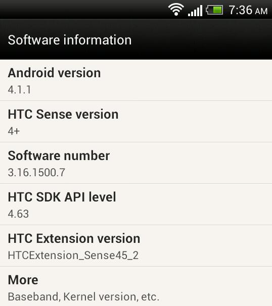

This is a screenshot of my current build #. I dont remember my previous build sorry!

is that your stock rom? or just a rom based on that build that your running? the impiortant part is the "1500" in finding a matchng carrier RUU
the main version is edited prior to the downgrade,so that it wont hinder the older ruu from flashing. you wouldnt neccessarily have to use that an ruu with that same build number(1500),as long as its compatible with your CID.

That's my stock ROM, which is what I'm currently running. It came from a Nandroid that I made prior to messing around with Custom ROM's... So 401's wont work,and 1500 is what I should be looking for? My carrier is Wind Mobile which is (Globalive).

We need to look for an ruu that either contains 1500 in the name, as the build number, or 1 that has your cid(GLOBA001) on the android info text document.

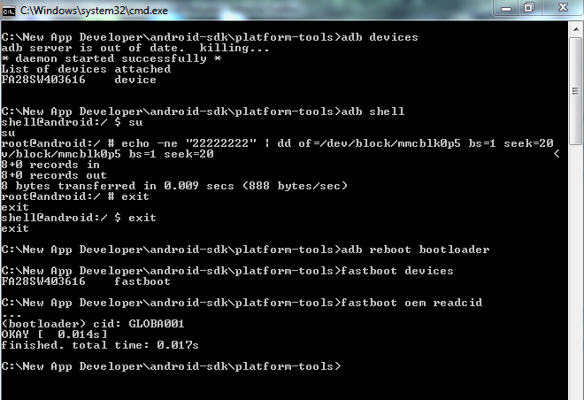

we are going to try the one vx/LTEvo method of supercid. heres what were going to do: one vx supercid
re-unlock,of youre not. install superuser if your not rooted.
enter the commands:
adb devices
adb shell
su (if needed to get #)
echo -ne "22222222" | dd of=/dev/block/mmcblk0p5 bs=1 seek=20
exit (exit again if you need to to get back to > )
adb reboot bootloader
fastboot devices
fastboot oem readcid (or fastboot getvar all if youd rather)

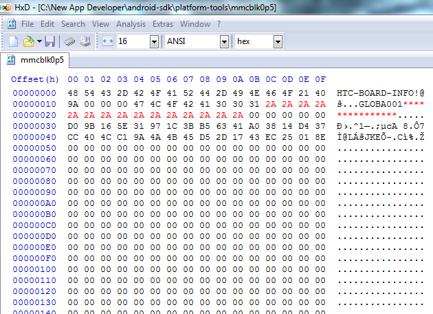

-dump mmcblk0p5 just like you did when following the supercid guide
-open it up and check it out. youll see your cid at offset 00000010x04.

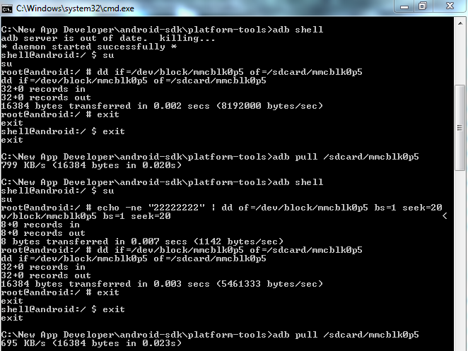

I tried it out, let me know if I messed up.. First attempt:I tried entering the commands as stated.. Second attempt I dumped the mmcblk0p5 like the supecid method, took a look at the file and saw my cid. Followed the rest of the procedure as stated and named it mmcblk0p5new but no changes... I'm entering the command "22222222", should I be entering it without the quotations (")(")??? Check out the screenshots.. Thanks.

you need to leave the quotes in place,you did everything just fine. looks like that block is being protected too :mad:

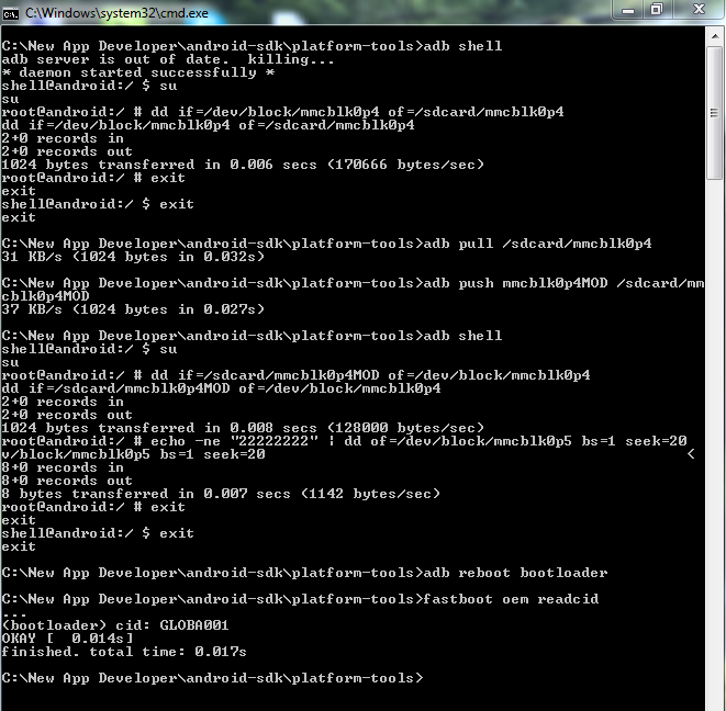

i wonder if one block is checking the other? my last suggestion before trying the hboot downgrade would be to try both processes at once...
-change the cid in mmcblk0p4 as you have been. before booting to bootloader,go ahead and change mmcblk0p5 as well like you just did.
-boot to bootloader and see if it sticks. if it does,reboot and see if it still sticks.
im pretty sure both blocks are write protected,so neither of them will change,but you never know ;)

Ok, I will try both process and cross my fingers, lol... If trying to change both doesnt work, I was going to try the RUU that I posted in post #41 with this method: http://androidforums.com/one-s-all-things-root/691874-guide-how-run-ruu-your-htc-one-s.html . Will that work or should I be trying that RUU after the Linux/brick method! I'm just not sure what you mean by the tools having the same HBoot as the RUU. I think the RUU that I posted has a 1.09 HBoot but I'm just baseing that on the title!
crap! :mad: so we know both blocks are protected and not performing checks on one another.
