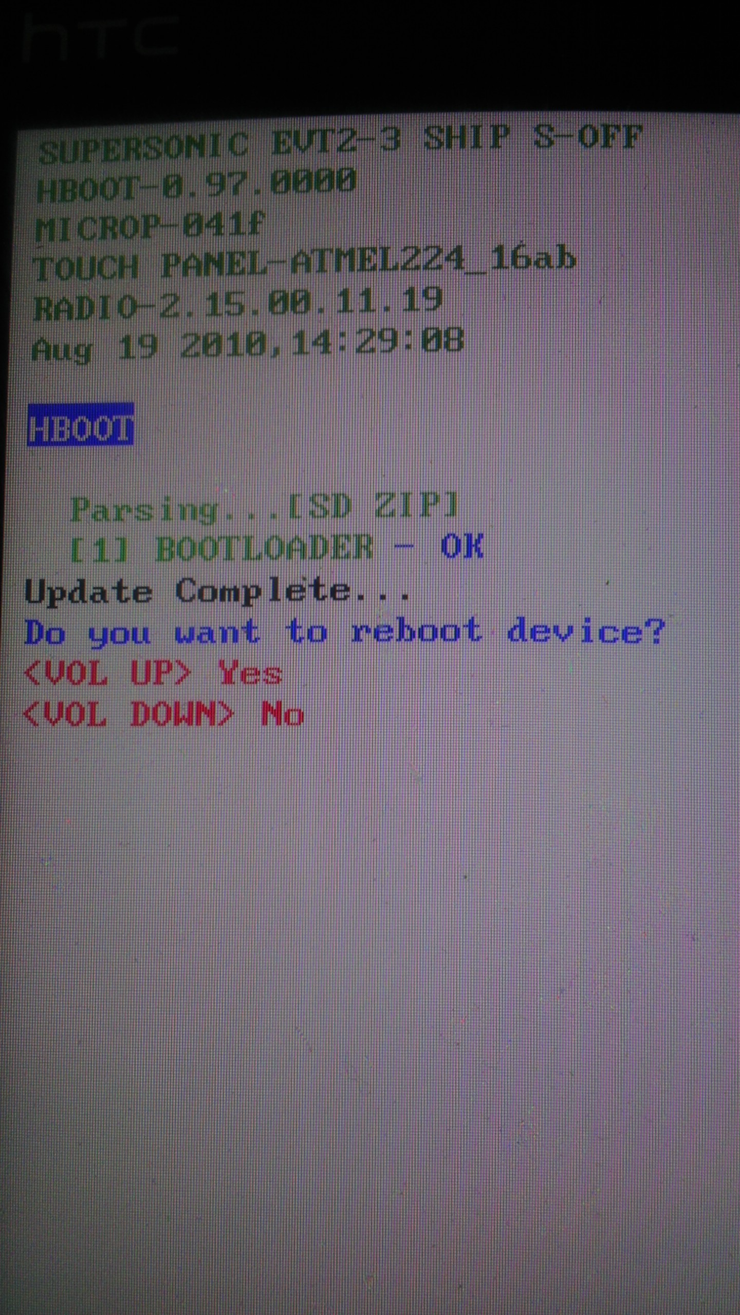

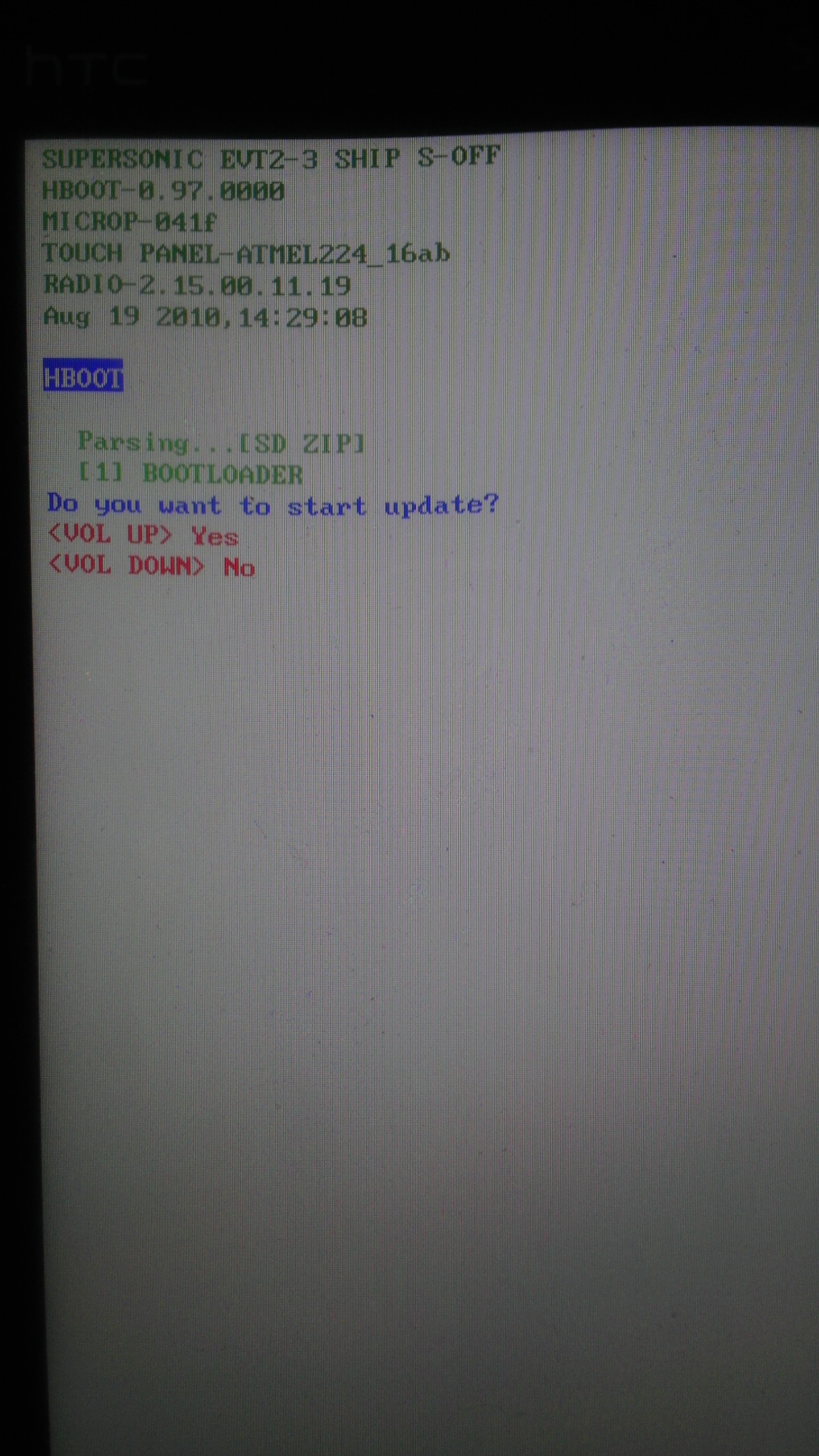

I reapplied unrevoked and s-off. When I went into hboot (Power+vol Down) PC36IMG went through and asked for update. i did vol up for yes and it updated but hboot still stayed 0.97.0000 and nothing updated. even tho it went thru the process and ok'd everything, nothing changed and no update
That's normal. Your hboot will remain the same after the PC36IMG.zip update. From the sounds of it, you're unrooted. To be sure, try running a root only app and see what happens.

s-off but asks for update???? still doesnt update. SU still works no fiemware update available no software update available
how to i get stock ota?

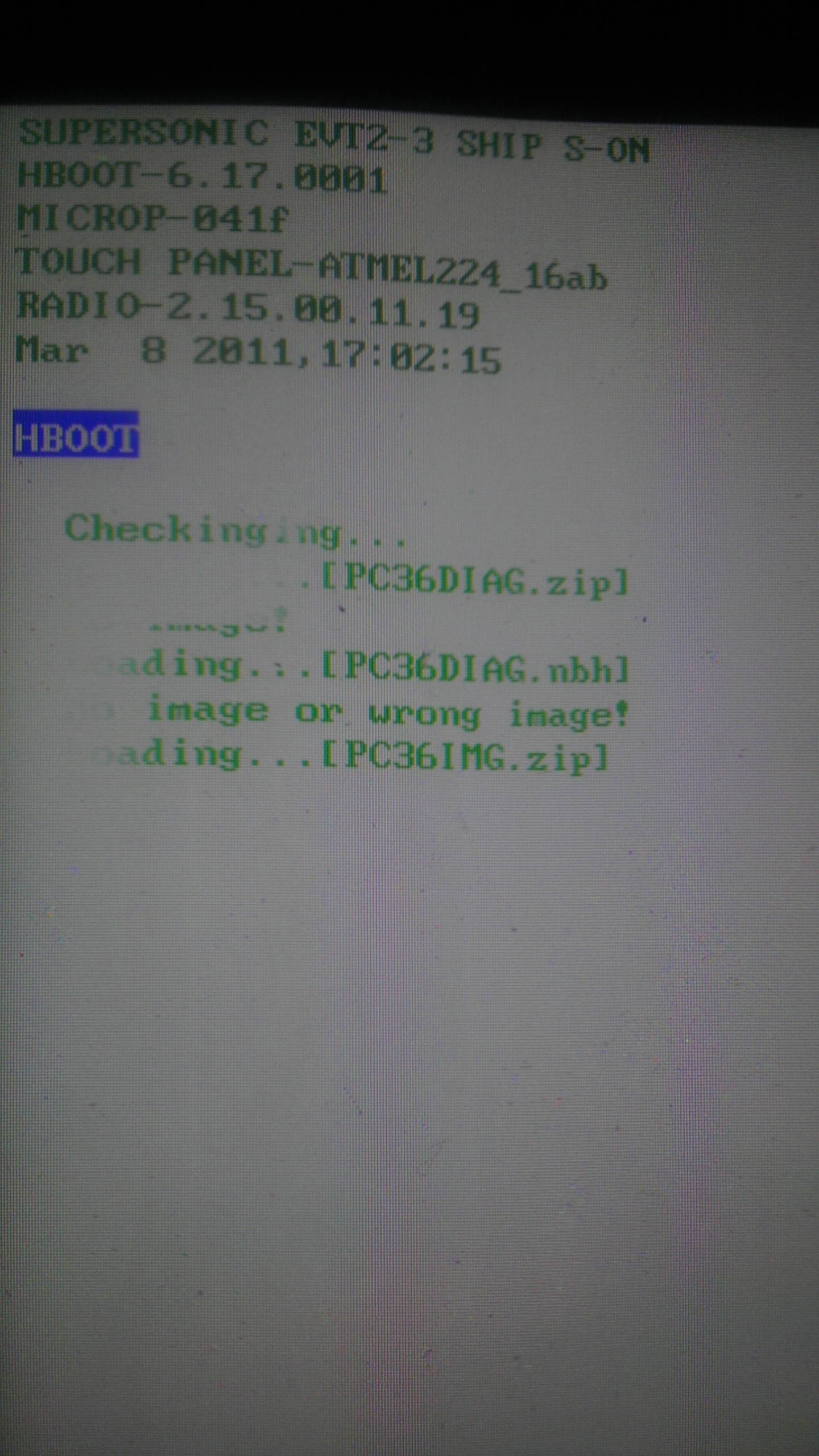

used s-on tool and I get this all the time.
I see hboot and date are changed afterwards
but still no update in hboot
no update found for firmware or htc software either

ok well that is odd that the earlier ruu which matches with what your phones radio is did not work. but since you have s-on, you can flash any of the updated ruu's with no issues.
i have other ruu's if you want to try those as well.
