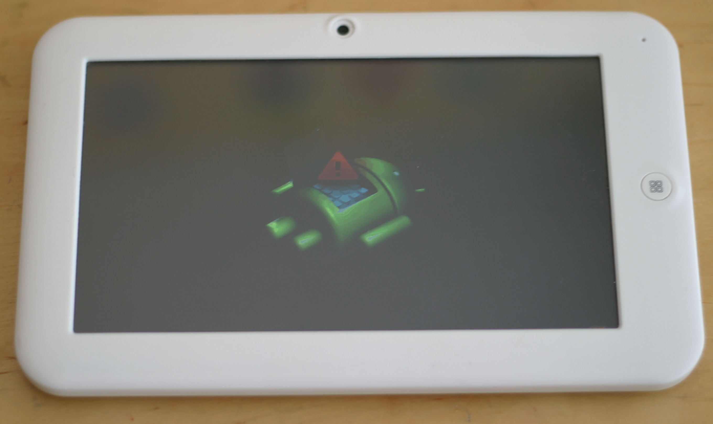

Hi. I've a friend's tablet here, a cheap and not so cheerful one bought for the children. I have no idea about the manufacturer or model number. No markings. The rom is crane_a710-eng.
It won't boot so I'd like to factory reset.
Vol+ and power get the usual opened up Android screen but there are no menu options available - I've tried all keypress combinations but no menu appears.

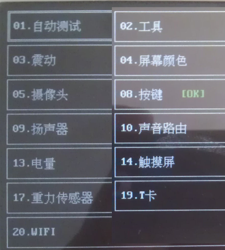

Vol- and power sometimes brings up a diagnostics / system menu but it is in Chinese.
Please can anyone help translate the menus or work out the menu option to change to English if there is one.

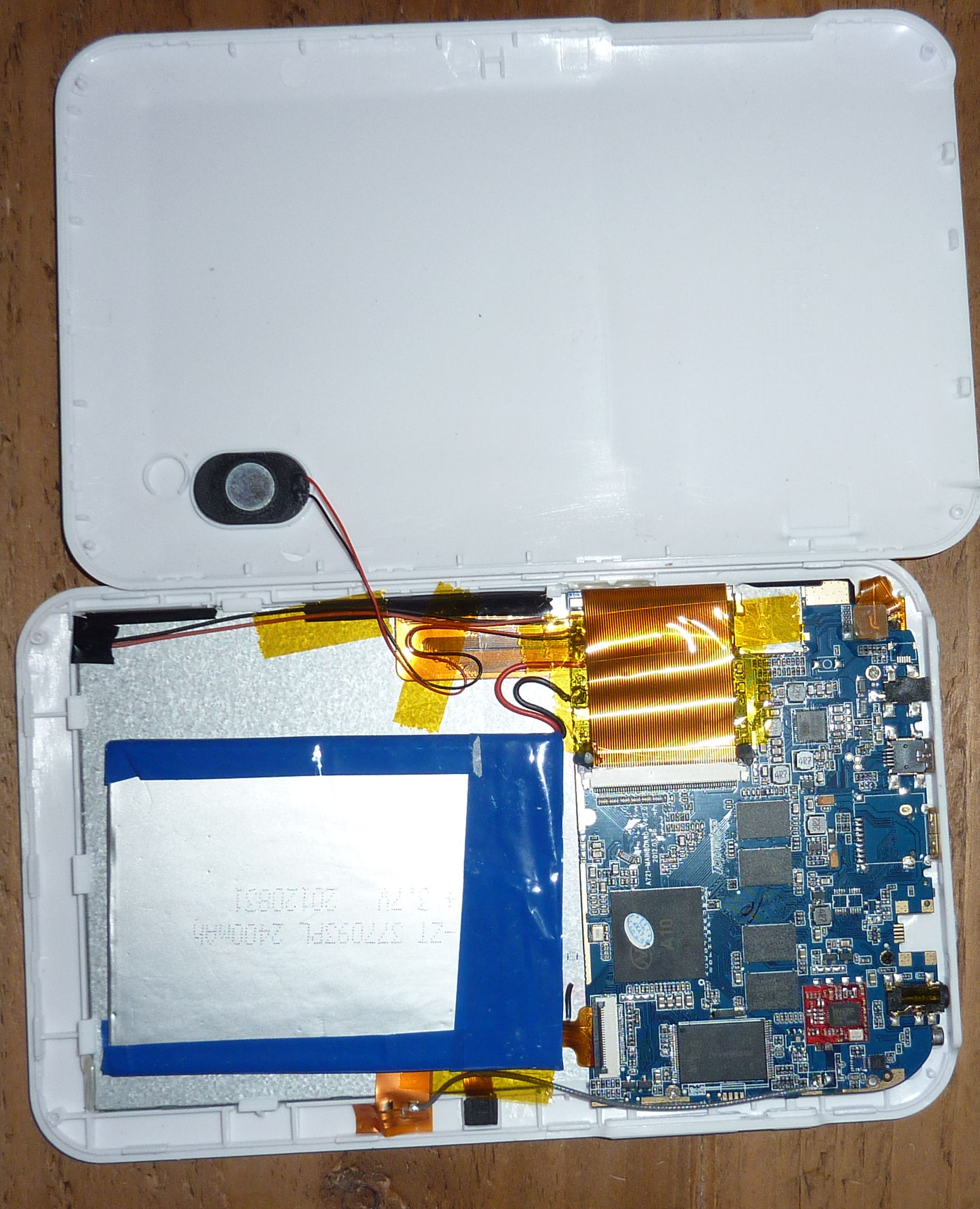

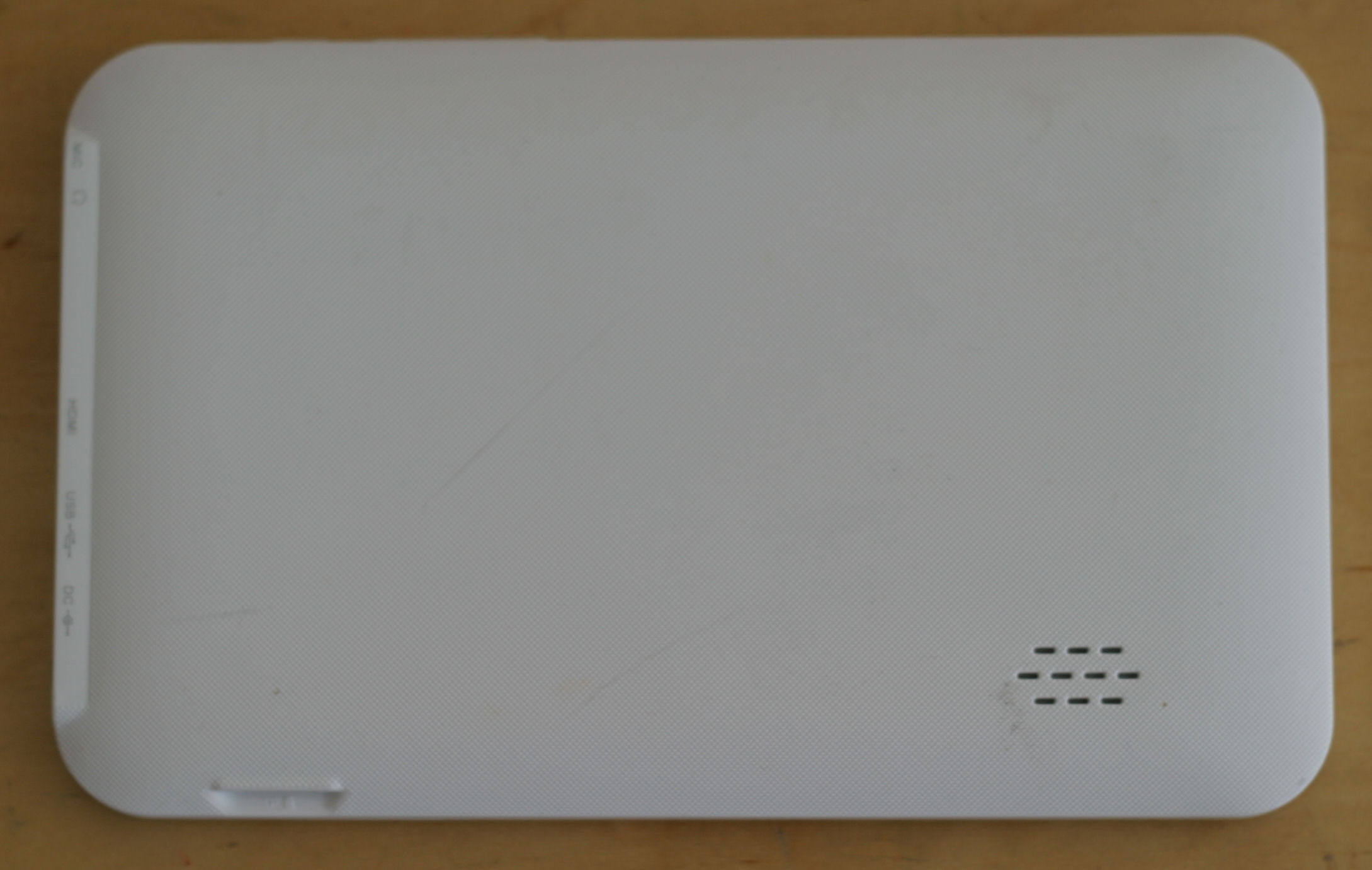

I've attached 1.jpg and 2.jpg showing the tablet if it helps id it (but I doubt it as it's so generic looking).

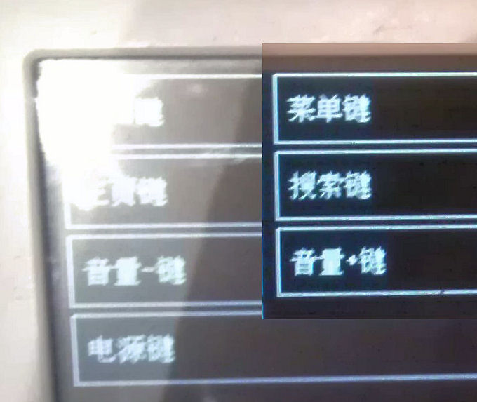

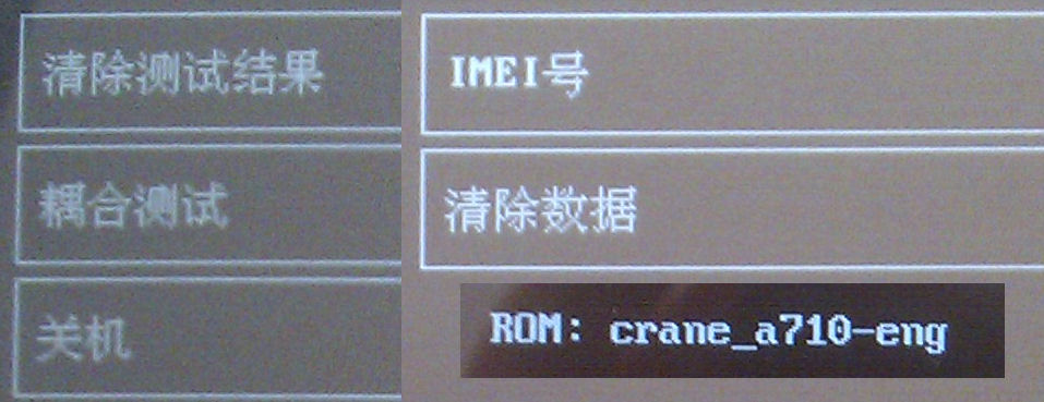

I've also attached menu1.jpg menu2.jpg and menu3.jpg. Menu1 is the main menu, the other two are sub-menus. Apologies for the poor quality of the menu pictures. I would try to take better ones but getting into the menu is very hit and miss and when I do get into the menu most of the time I can't select anything.
