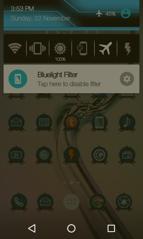

I can confirm that everybit of this ROM is working including theme engine(I have attached some Screenshots for reference and the yellow screen overlay is the blue light filter from play store to save my eye a bit lolo_O, I forgot to turn it off and no time to get extra shots. So sorry about that.), Root(built in), Battery Optimization(Per App/or all at once, even more battery saving), Internal Storage(MTP via PC), And everything else I had no restarts so far or freezes. Just a fresh install and everthings perfect. But if its other LG L70 model related that's another story. I have a LG L70 D320n model and its problem free on this ROM. Cheers and thanks once again for this awesome ROM vm03.

Well I am in the older CM13 11-06 build as you can see in screenshots attached in my earlier post. So I don't understand what you are talking about here now "Well the theme was probably then not compatible with cm13, I thought it said it."o_O.
