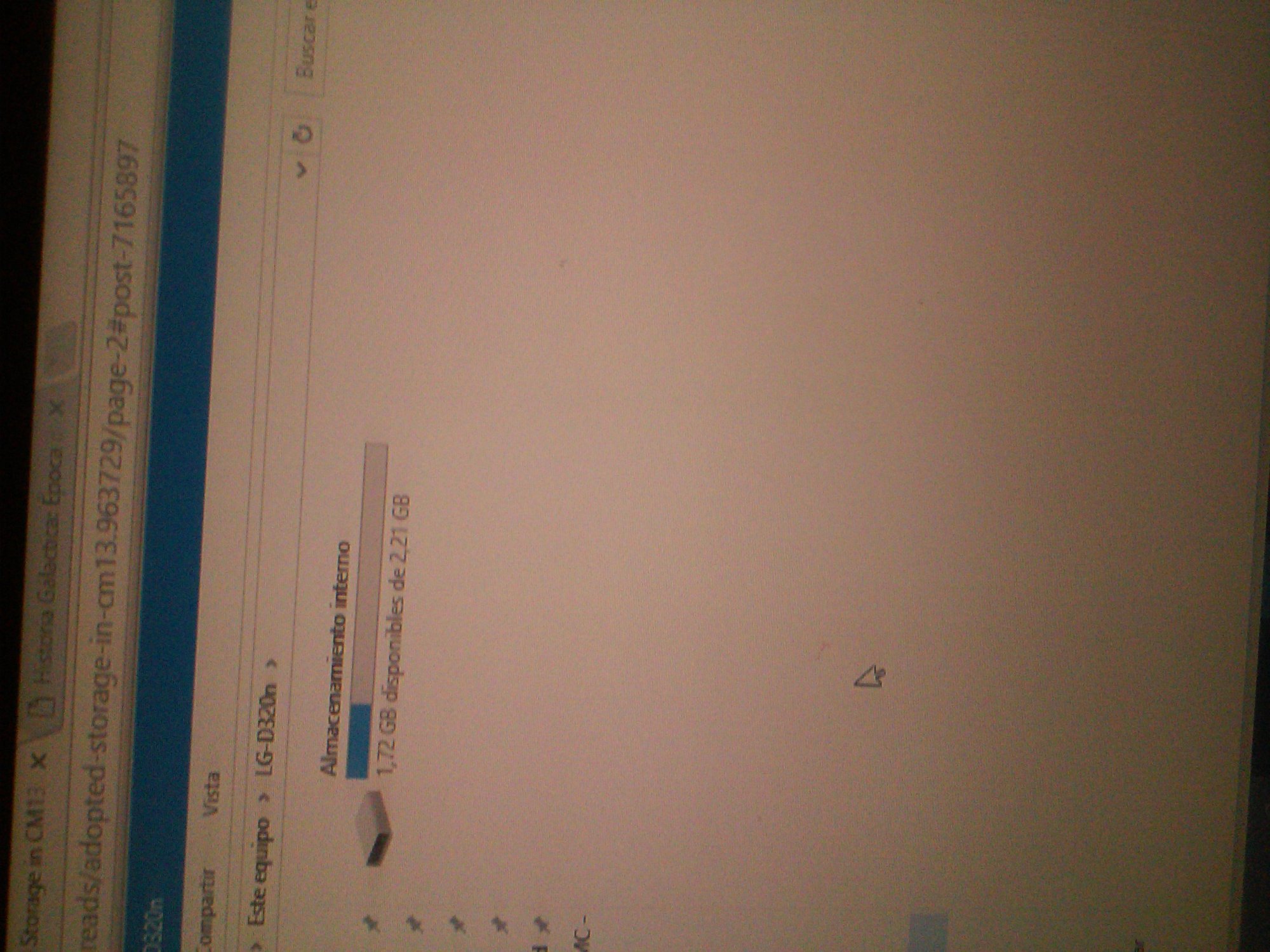

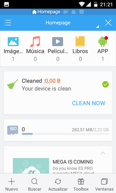

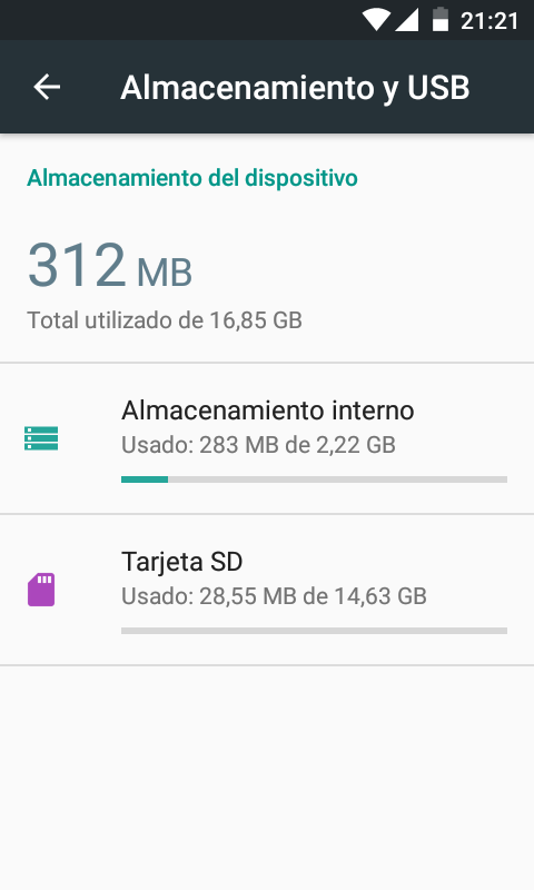

After making the distribution memory @vladimirs77 , I install zip from sd CM13 try to put me as internal and not recognized as such
