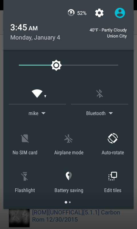

Someone please help me I'm trying to use a MetroPCS sim but it keeps saying no sim detected. I am on the latest nightly

I'm also the owner of LG L70 D325 (Dual Sim) and everything works fine...
Android can't detect your SIM because you used aboot.bin for D320 (during CWM/TWRP recovery flashing), and not D325...
