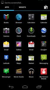

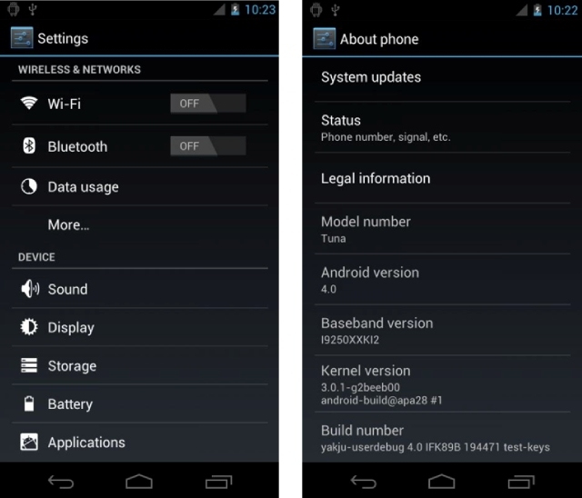

The screen shots are attached with post see down
