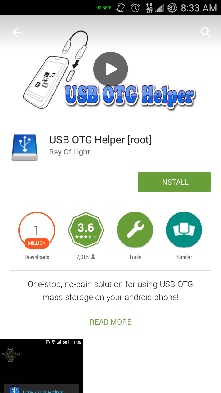

It will mount your usb stick to /sdcard/usbstorage/sda1

Well, root with stick mount pro works great.
You don't keep getting annoying notifications? When I use the pro version it mounts /sdcard/DCIM to /sdcard/usbstorage/DCIM and gives me persistent ongoing notifications that I can't get rid of as well as annoying toast notifications on every boot. I ended up uninstalling the stick mount pro extension, then deleting /sdcard/usbstorage/DCIM(had to use TWRP file manager because Root Explorer could not delete it). Since I went back to using the free version, I have had zero problems.

I am able to get OTG working with a mouse+OTG cable on my Zmax (even without root), but I haven't had any success with flash drives. I obtained temp root with Kingroot, and root access was verified with Root Checker. Using USB OTG Helper, it reports that "Root access is OK!".
However, when I try to mount a flash drive, it tells me "No drives mounted (code 9)". I do see the red LED light on the flash drive light up while it's plugged into the Zmax via the OTG cable.
I don't know what I'm doing wrong or what I need to do to get OTG support for flash drives. I would appreciate any help. Thanks.
