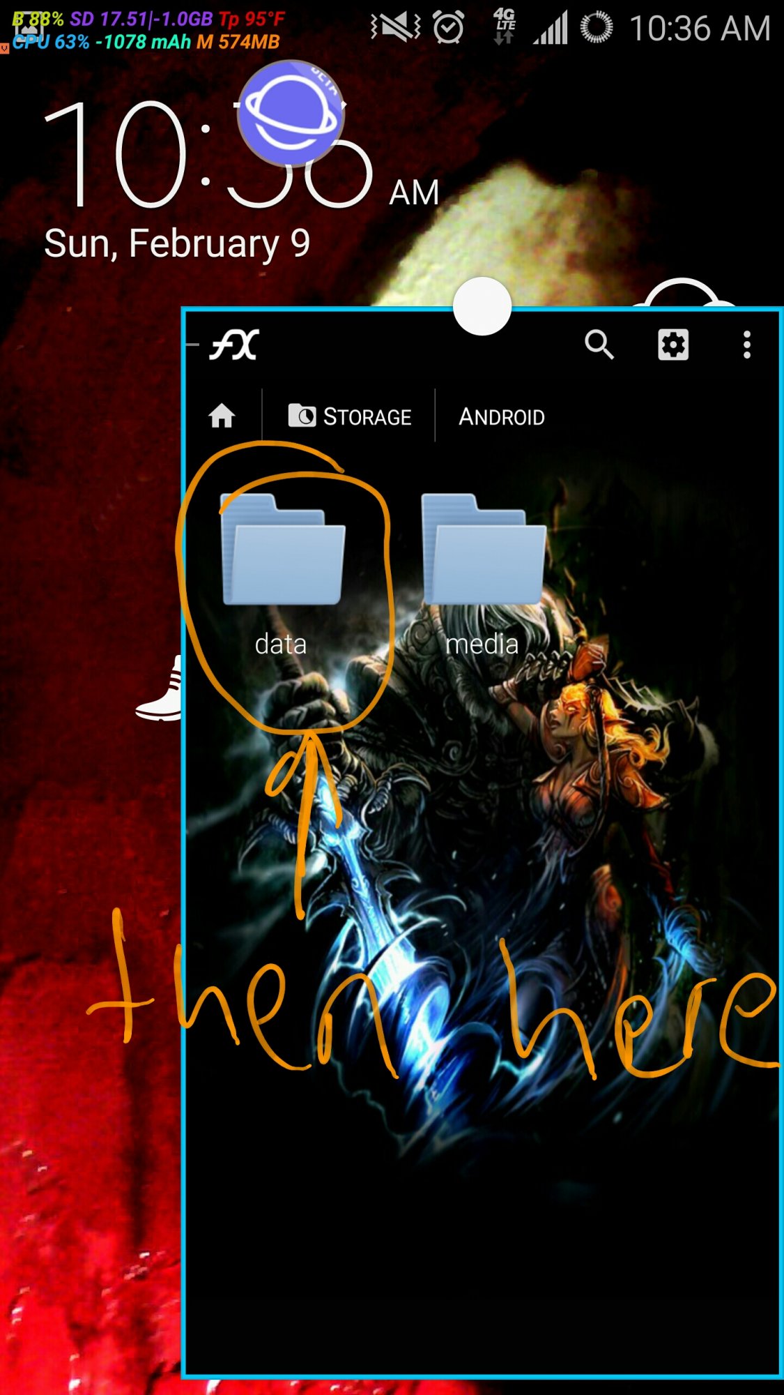

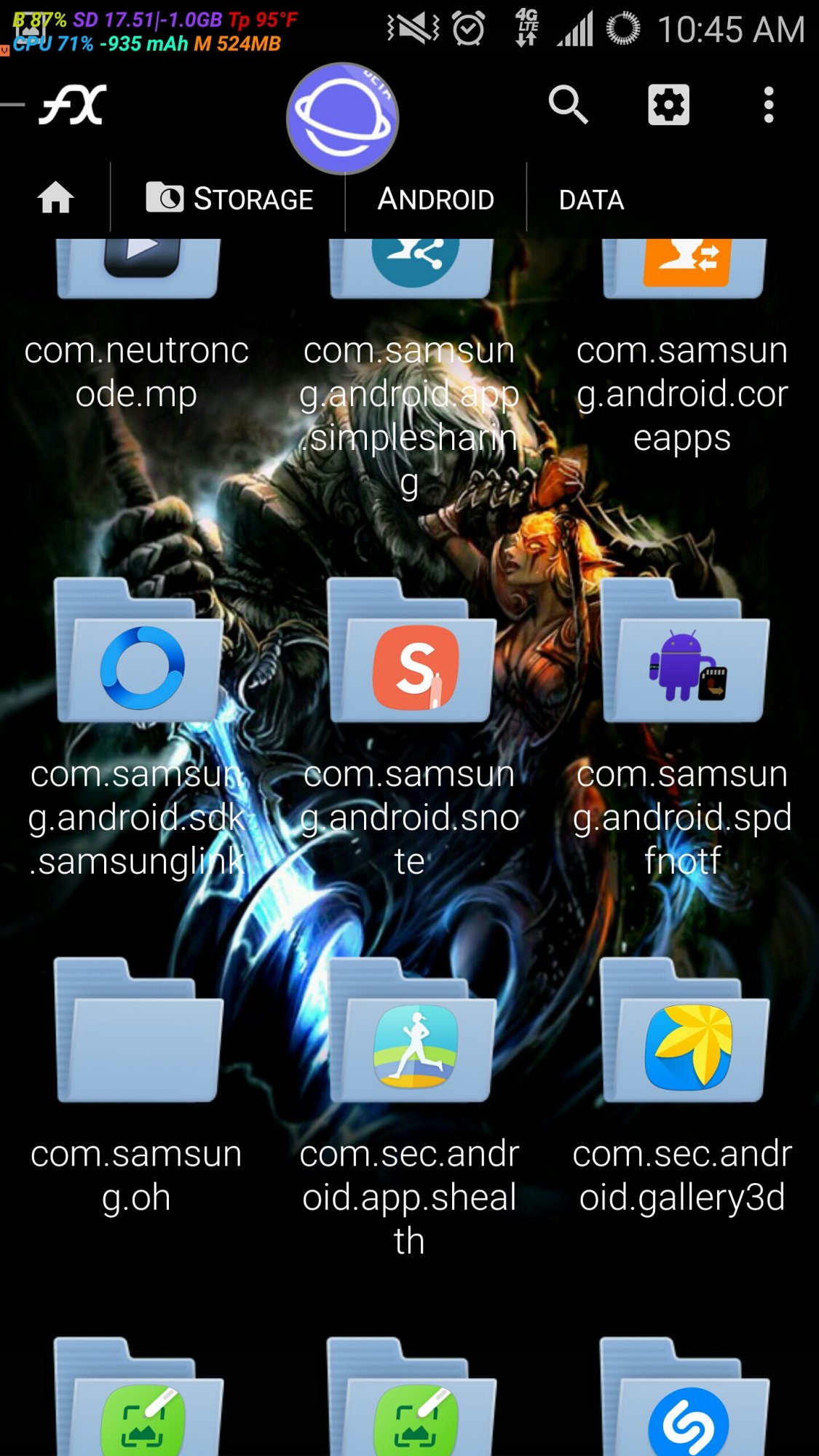

I see what you are saying..I'm having that issue too every since I installed this costume rom a few days ago..the original stock version didn't have that..I've tried to delete that folder but it will populate back up right away..maybe some one has a solution
