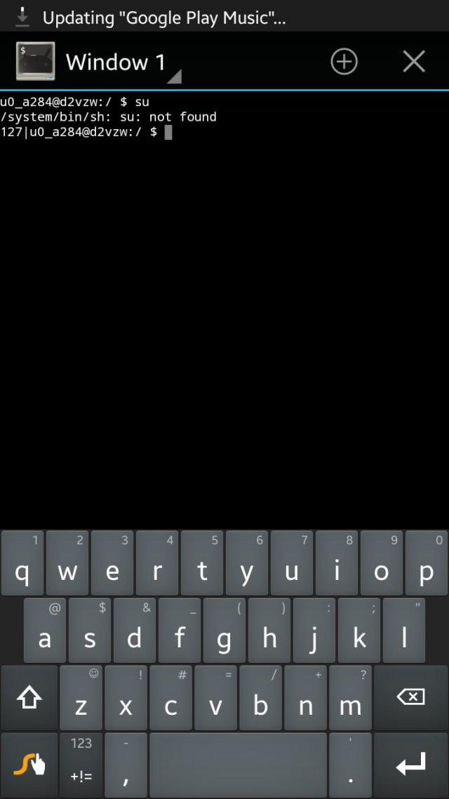

If you fire-up an Android Terminal app session and type "su", do you get the "#" prompt?
Nope. We get this.
I successfully received the "#" before when I had root when I typed "su" in.

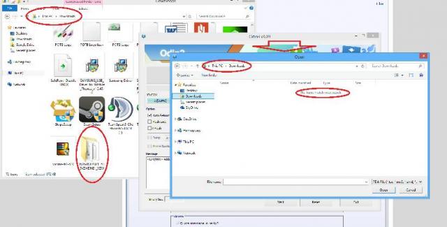

I'm trying to add the firmware file to Odin under "AP", but it doesn't seem like it's showing up when I follow the file path. I'm following the same steps to install firmware in this video (https://www.youtube.com/watch?v=4NMTWvXQPjk), except I'm using the firmware Mikestony showed me earlier. The only difference is that the I535VRUDNE1_I535VZWDNE1_I535VRUDNE1_HOME.tar.md5 file isn't showing up in the "Open" file explorer.
I downloaded and extracted the files, I connected my phone to my computer (successfully now), started recovery mode on my phone, started Odin, confirmed the checkboxes, clicked "AP", followed the file path, and couldn't find the ".md5" file.
Anybody know why I can't find it? :confused:

This is what I'm seeing. Unfortunately... this is low quality.
It's me showing my file paths on both file explorers, the folder existing in my downloads folder, and the Odin explorer not finding it.
(Sorry for double posting. Couldn't add this photo in the previous post.)
