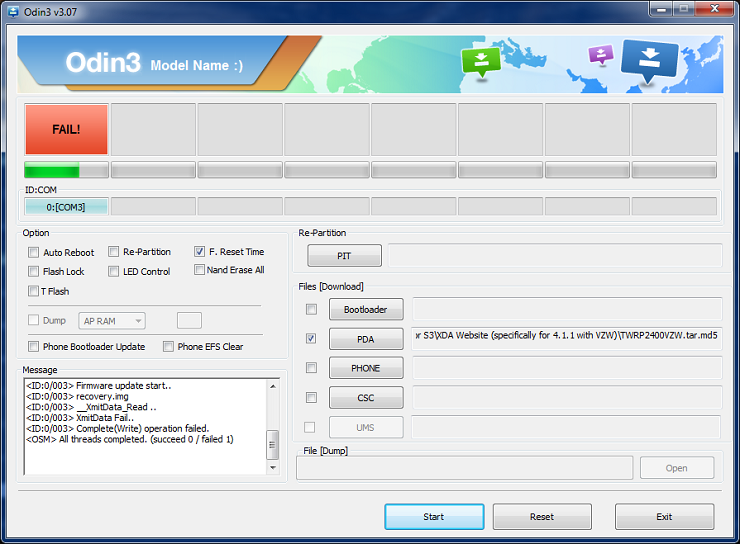

Attaching the TWRP error. Thanks so much for all the help though. I really appreciate it. I've had to resort to going back to my rooted Incredible 2 in the meantime. The difference is NIGHT and DAY, lol.
