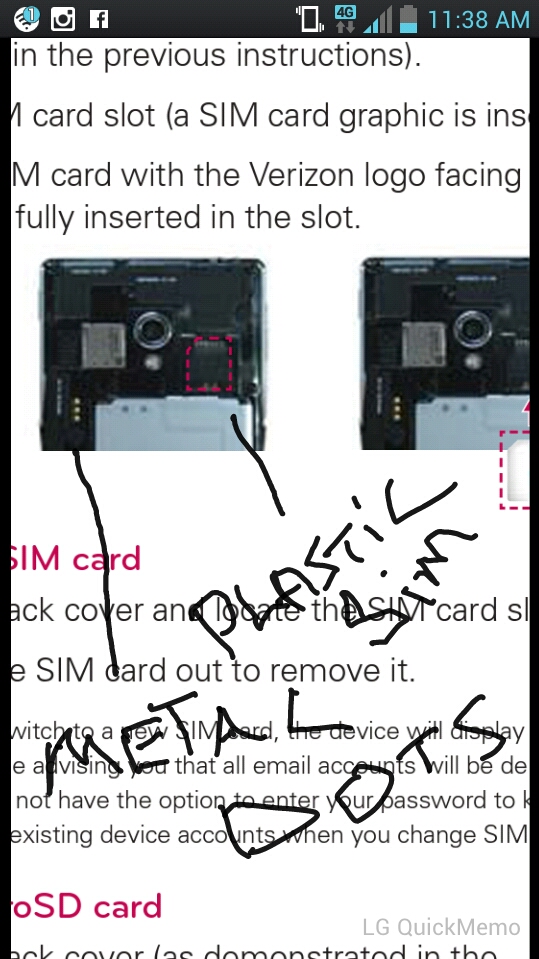

The lg spirit supports NFC and wireless charging??
No it doesn't im afraid i looked at the vs 870 pdf and the picture clearly shows that there is three metal dots on the inside back of the device in the back cover and the sim card holder is plastic not metal necessary for nfc waves to pass thru so in short no nfc or rf charge for the spirit. .2013-03-27-11-40-02.jpg
