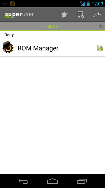

I've got to be rooted because I installed 4.04. I installed Busybox from the market which also gave me the same error. It says to allow them root access via superuser. However, I don't see that option under "Superuser". Do I have to install the elite version to be able to do this? See screenshot below. I was able to "toggle" ROM Manager" to "allow" but still have the same problem. I wonder if I lost root after flashing 4.04.

I actually ended up using another toolkit which ended up working, but the main issue I was having was that file wasn't being renamed in the root process, and that was preventing it from sticking. I'm on my phone right now but when I get on my computer I'll PM you the link to said toolkit. After I used that, I was able to flash roms and everything manually and haven't had any use for the kit since.
It might be that the su binary you have is out of date and/or not compatible with 4.0.4.
I've seen this a few times now related to 4.0.4 (mostly for the GSM version, though).
Flashing this su.zip should re-give you root.

It sounds like u don't have root. I would hook back up to wuugs and reroot its not going to hurt.
Glad you figured it out. I had a similar problem, but found out I accidentally flashed the non-rooted 4.0.4. When I did that I ended up flashing my first backup (made one right after rooting and unlocking) to 4.0.2 through recovery, and root was back.
Root is sticking now? Were you able to do it through Wugs?
Yes, I just rooted it again with Wugs. I flashed a different rom now and everything is working fine. Thanks again.
