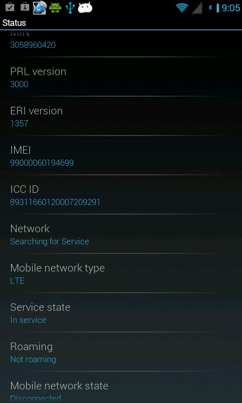

Okay the first time I tried this I was rushing and skipped a step so my phone is actually out of test mode. Later I called someone at metro for help they told me some numbers to enter into some hidden menu now my phone has information in it. All I have to do is get the service working, but maybe some things are wrong
Just try to update your PRl as normal via *228 option 5. Maybe that will work. ???
