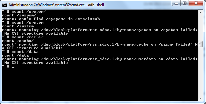

have access to cwm, already I tried installing a custom ROM, but the error in the mounting system, this taking to enter the cwm,
the error of cwm: mounting / cache /
mounting / data /
and mounting / system
already tried to do hardreset and install a custom rom, but is locked in the boot screen, I insert an attachment here the log LGMObilesupporttool, tried to use two laptops and nothing, tried reinstalling drivers and msxml and nothing.

above is the log adb, I tried to move the aboot, but it did not work, the error persisted

I try this and i get:
