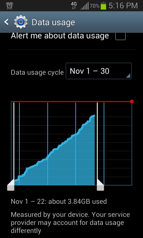

Yep, really. Moved from an evo to the victory a couple months ago. Get great strong LTE around Knoxville. Almost 4GB so far this month on LTE, no throttle.
Edit: Speedtest results too for Knoxville area.

So VM will still throttle 3g?? Because I thought they throttled 4g to 2.5Gb but I guess not :/
I was definitely being throttled on my evo on 3G, yes. Always got the text that you've gone over data limit and speeds will be throttled until next billing cycle. I've never been throttled on 4G on my victory. Just checked my logs, used 5.2GB last month with no throttle on 4G.:thumbup:
