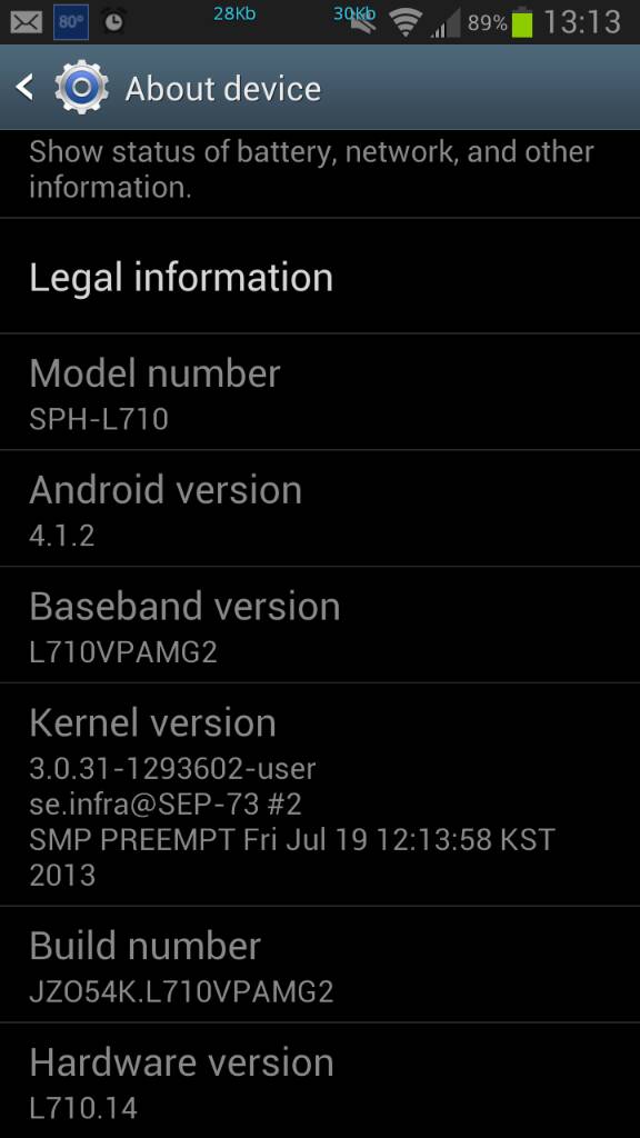

Also I wanted to make note that my baseband version also updated to MG2. I remember seeing it posted that the baseband didn't update but mine did.
The baseband was not changed in this update even if you let the phone install it from stock... The build was changed to MG2 but my baseband is still MD7
Weird. I followed the steps you posted and my baseband did in fact update.. ?
