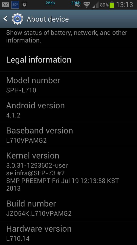

The baseband was not changed in this update even if you let the phone install it from stock... The build was changed to MG2 but my baseband is still MD7
Thanks for this but I'm just a tad confused How is it that we change our baseband to MG2 .. I flased both files with a back up I had of youre rom but I just restored system and boot then flashed both files and after about 6-10 min it booted up fine I did how ever lose root ( and I used twrp)
I'm a bit confused too as this update did in fact change my baseband to MG2:
