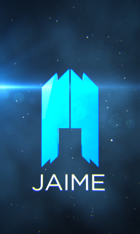

well the stock one was at 480x800 and thats exactly what i used, i made this for the fore mentioned thread i made on xda, its just a zip with everything i have for the boot screen if you want to take a look
jaime custom boot ani
but i really cant understand why i cant get this to work -_-
edit: ill attach one of the jpg's if you dont want to download the zip ;P
By that I mean read/write instead of read only. In ES file explorer, you turn root explorer on, click on the root explorer text (not the on off button) and I believe it says mount partitions or something similar. Change /system to r/w. I'm going to download the zip real quick and try it, to see if it'll work for me
Edit: the boot animation wouldn't play, it was just a black screen. I opened it up and made sure it was just the boot animation, and rezipped it. I am pretty stumped here :/
shark, were you able to use other boot animations? could it be something with my format? i rendered it to a jpeg sequence from after effects, is there a right way to change a video to a jpeg sequence for these animations?
