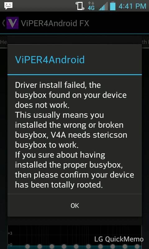

I'm using the deodexed v6 rom. So far, everything seems fine. The only issue I've run into is viper4android. It won't install the driver. It says busybox is broken. I reinstalled busybox and still no luck. I had no problems on stock v6 routed with saferoot. Other than that, everything works perfectly.
Strange that it says it's broken. It's used during the installation of the Rom. It's located at /system/xbin/busybox
So I just ran saferoot successfully and tried again. I attached a screenshot of the error message. Even after saferoot, it still doesn't work. Root explorer and link2sd work fine though.

Looks like it's not compatible with the version of busybox thats installed. The screenshot you posted says it works with stericson busybox. I'm guessing the version installed is not that. The android kitchen says it's the newest busybox.

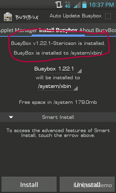

You need to install Stericson's Busybox Installer to update busybox. Run the app and under "Install Busybox" you should see the version you have now. Click "Install" at the bottom left of the screen. This will update your busybox to version 1.22.1-Stericson and hopefully that will fix the problem.

I didn't think it would work. They are the same version. viper4android must require an older busybox.
