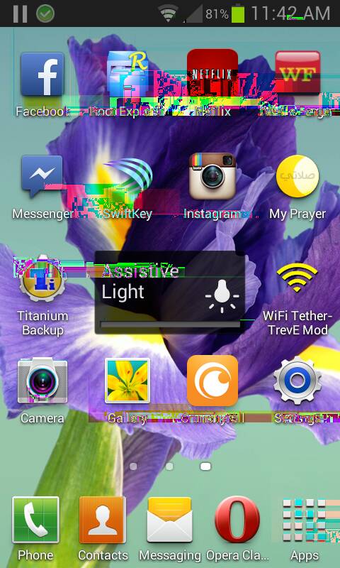

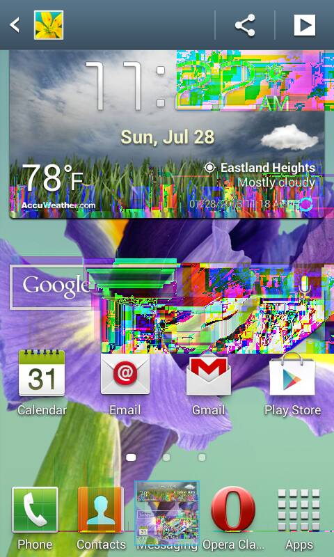

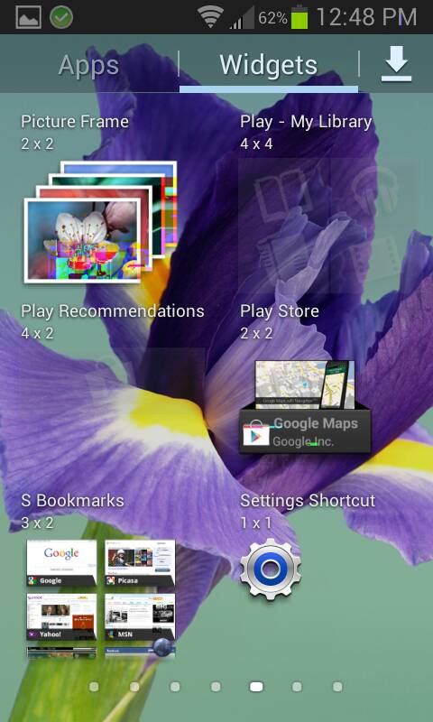

hey I mentioned in another thread that I experienced a voltage error withe the VaeVictus Kernel. I had discoloration with widgets, icons, boot logo and more. I have attached a few photos of what it looks like. This may not look serious but many times my phone would just freeze up and crash and boot loop to. With horrible looking colors. So apparently I tried underclocking it but it didn't do anything. So I was forced to reinstall Redspots 0.04 Kernel. I am in no way nagging to you guys like a little baby, but I would like to Install the new Kernel and this voltage issue is the only thing holding me back. I just want to let you guys know that this issue is out there. Thanks for all the hard work you guys have doing :D

What settings were you using?

What does you mean specifically? I tried all the governors taking it back down to 1.5 ghz over a span of a couple of days. Just had issues. Never did any extensive changes besides the Rom and Kernel. If that answers your question. I'm back using Redspot and everything is buttery smooth. Again, if that answers your question. I tried using setcpu and an tutu, same results.

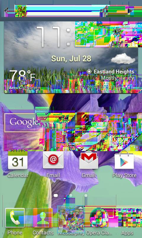

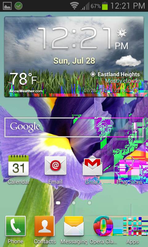

Dammit it came back. Nooo(darth Vader voice) flashing back to Redspot. Asside from the discoloration the responsiveness is like project butter

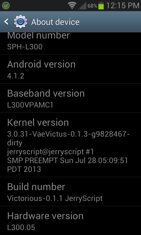

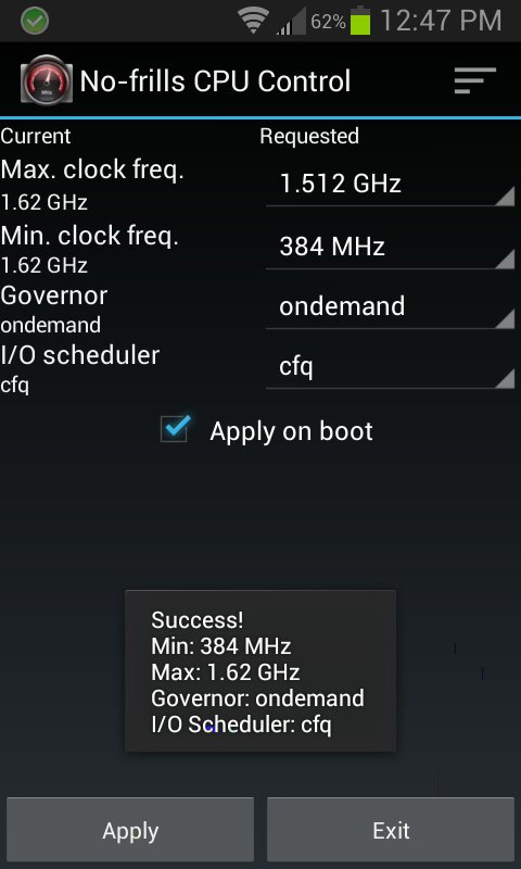

What gov and freq are you on? and can you post a screenshot of settings>about phone whenever u can...
Ok i installed it again am im really fooling around with my freq. I'll post pics in a sec. So i brought the Freq down as low as 1.3ghz conservative and the glitches and color problems have stopped and now I'm slowly bumping my way up until I see any glitches (I keep the min 384 mhz by the way), but one thing I have noticed is that whenever I test the Freq stats in No frills my cpu spends alot of time clocked at the highest freq for no reason. Not sure if this helps but I'm about to post pics
Well from what I've seen the moment I hit 1.5 ghz maybe 1.6 my phone started bugging out I switched between conservative and on demand. By the way I am also running version 0.1.1 of JerryScript because I don't want that link2sdcard stuff. Could this be a contributing factor?

Yeah I borked the the voltages for the freqs between 1.5 and 1.8 so basically only yhos actually work. I fixed them on github so whenever JerryScript compiles it, all these problems will go away.
