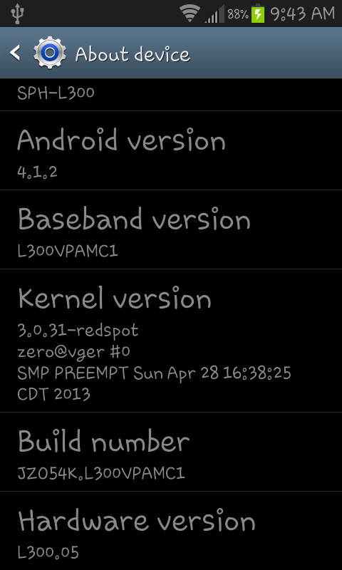

I worked on a kernel for the vmsgv 4.1.2 yesterday and it has been running on my victory with no stability issues. I have not been able to get tethering working but that may be an app issue, i just don't know enough about it. If someone can show me what should be enabled in the kernel i can compare it to what i have and redo if needed. Here is the kernel...
http://planetjupiter.com/android/share/RedSpot_VM_SPH-L300_v.01.zip

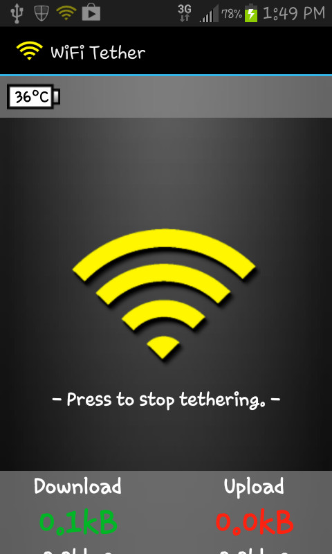

my settings for tethering
# Networking options
CONFIG_COMPAT_NET_DEV_OPS=y
CONFIG_PACKET=y
CONFIG_PACKET_MMAP=y
CONFIG_UNIX=y
CONFIG_XFRM=y
CONFIG_XFRM_USER=y
CONFIG_XFRM_MIGRATE=y
CONFIG_NET_KEY=y
CONFIG_NET_KEY_MIGRATE=y
CONFIG_INET=y
CONFIG_IP_MULTICAST=y
CONFIG_IP_FIB_HASH=y
CONFIG_IP_PNP=y
CONFIG_IP_PNP_DHCP=y
CONFIG_IP_PNP_BOOTP=y
CONFIG_IP_PNP_RARP=y
CONFIG_INET_DIAG=y
CONFIG_INET_TCP_DIAG=y
CONFIG_TCP_CONG_CUBIC=y
CONFIG_DEFAULT_TCP_CONG="cubic"
CONFIG_ANDROID_PARANOID_NETWORK=y
CONFIG_NETFILTER=y
CONFIG_NETFILTER_ADVANCED=y
# Core Netfilter Configuration
CONFIG_NF_CONNTRACK=y
CONFIG_NF_CT_PROTO_GRE=y
CONFIG_NF_CONNTRACK_FTP=y
CONFIG_NF_CONNTRACK_IRC=y
CONFIG_NF_CONNTRACK_PPTP=y
CONFIG_NETFILTER_XTABLES=y
CONFIG_NETFILTER_XT_MATCH_IPRANGE=y
CONFIG_NETFILTER_XT_MATCH_MAC=y
CONFIG_NETFILTER_XT_MATCH_MULTIPORT=y
CONFIG_NETFILTER_XT_MATCH_RECENT=y
CONFIG_NETFILTER_XT_MATCH_STATE=y
# IP: Netfilter Configuration
CONFIG_NF_DEFRAG_IPV4=y
CONFIG_NF_CONNTRACK_IPV4=y
CONFIG_NF_CONNTRACK_PROC_COMPAT=y
CONFIG_IP_NF_IPTABLES=y
CONFIG_IP_NF_FILTER=y
CONFIG_IP_NF_TARGET_REJECT=y
CONFIG_IP_NF_TARGET_LOG=y
CONFIG_NF_NAT=y
CONFIG_NF_NAT_NEEDED=y
CONFIG_IP_NF_TARGET_MASQUERADE=y
CONFIG_IP_NF_TARGET_NETMAP=y
CONFIG_IP_NF_TARGET_REDIRECT=y
CONFIG_NF_NAT_PROTO_GRE=y
CONFIG_NF_NAT_FTP=y
CONFIG_NF_NAT_IRC=y
CONFIG_NF_NAT_PPTP=y

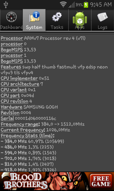

Ok i was able to get back to it and using 'WiFi Tether for Root Users' it worked. I can make whatever changes anyone wants on this by the way. I couldn't figure out a way to screencap while tethering from my tablet but... heh
I swear i tried my best to NOT mess with this thing as i know how complicated stuff tends to melt my brain. But when i couldn't do stuff i should be able to do on MY device well, stuff is oozzing out my ears as we speak. I can make whatever changes anyone wants on this by the way.

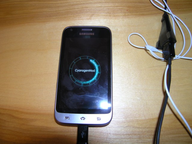

Lookie what we have here :)
While she now boots I am getting NFC and Phone errors once I hit the desktop which leaves the phone unusable. This is caused clearly to permissions problems in talking with the Radio's. Still needs some work but at least it's booting up now!

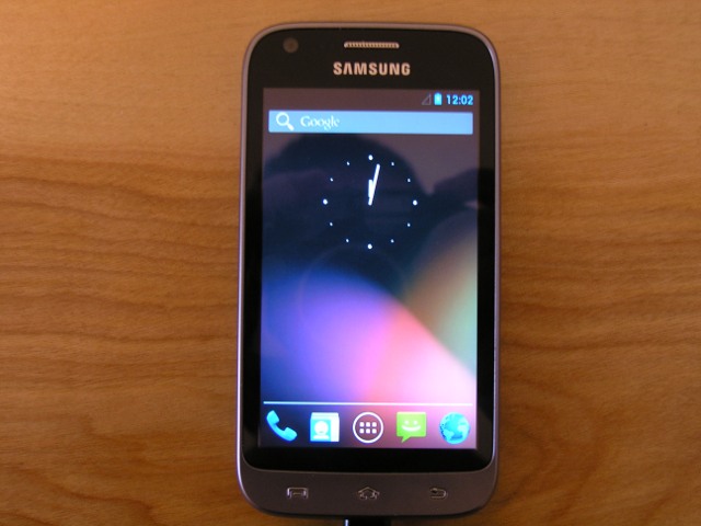

Getting closer houston we now have lift off. We made it to the desktop. Just still a crap load to fix as not much works...no sound, wifi, bluetooth, nfc, camera, usb...etc etc.
